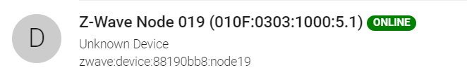

I have problems to get FGR-223 Roller Shutter 3 running
The Log show the following message:
2019-06-15 20:48:15.723 [WARN ] [wave.discovery.ZWaveDiscoveryService] - NODE 19: Device discovery could not resolve to a thingType! 010F:0303:1000::5.1
2019-06-15 20:48:15.736 [INFO ] [g.discovery.internal.PersistentInbox] - Added new thing ‘zwave:device:88190bb8:node19’ to inbox.
BasicUI show the following Thing:
Thing details in BasicUI:
Z-Wave Node 019 (010F:0303:1000:5.1)
Unknown Device
This device has not been fully discovered by the binding. There are a few possible reasons for this -:
  • The device is not in the database. If the device attributes show that this device has a valid manufacturer ID, device ID and type, then this is likely the case (eg. you see a label like " Z-Wave node 1 (0082:6015:020D::2.0) "). Even if the device appears to be in the database, some manufacturers use multiple sets of references for different regions or versions, and your device references may not be in the database. In either case, the database must be updated and you should raise an issue to get this addressed.
  • The device initialisation is not complete. Once the device is included into the network, the binding must interrogate it to find out what type of device it is. One part of this process is to get the manufacturer information required to identify the device, and until this is done, the device will remain unknown. For mains powered devices, this will occur quickly, however for battery devices the device must be woken up a number of times to allow the discovery phase to complete. This must be performed with the device close to the controller.
Status: ONLINE
HIDE PROPERTIES
zwave_beaming true

zwave_version 5.1

There are some good news about your issue.
First of all, your device is in the current database, second you have the better firmware version 5.1.
The bad news is, the device wasn’t available in 2.4 releases, so a later version is needed.
You need to at least update the Z-Wave binding by copying the .jar-file in the openhab2-addons directory. The latest snapshot can be found here.
Don’t forget to confirm you’re running the correct binding version, e.g. by using bundle:list in karaf console.
