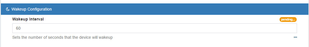

First is wakeup interval that is 0. Try to set it to i.e 60:
It has been stuck at pending for over 1 hour. Then I check Association Groups. All empty so I try to set OpenHab to the 1 group:
Also stuck at “pending”. I have tried waking up the device about 50 times standing right next to the Z-wave stick…
