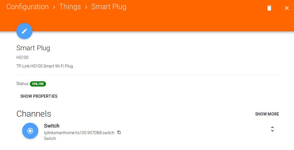

Also in PaperUI, for the thing, check to see if there are more channels by clicking the “show more” button. Sometimes not all channels are shown until this is clicked.

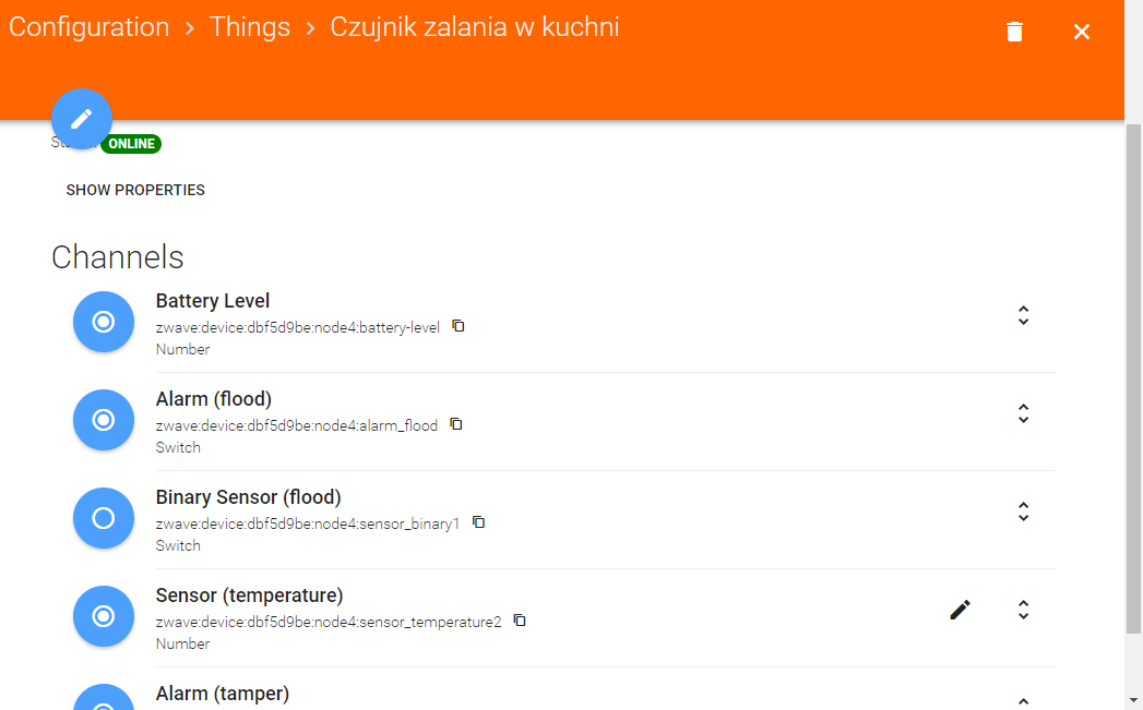

PaperUI reports alarm_tamper2 as a switch.
As for this “show more” button (or rather “show properties”, I believe), this did not change anything in channels list.
Show more button on the left side like this example:
Screenshot%20at%202018-11-18%2012-16-22
You may or may not have more channels, just a suggestion to try.
