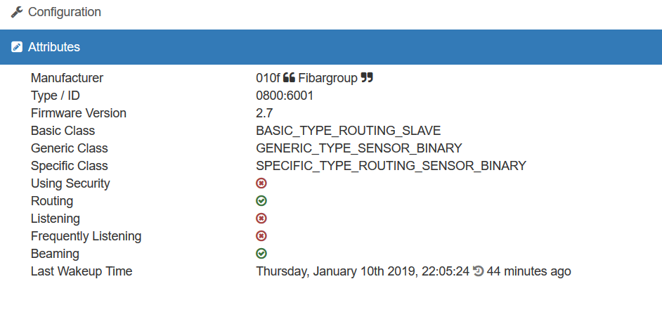

Hi, I am also facing similar issue. Looks like my new zwave and zwave+ Fibaro devices are not in database. After inclusion all devices are showing as unknown. If so how to add the entry in the database ?
Here is the snapshot for motion sensor FGMS-001 (zwave)
zwave+ device FGS222 v2.2 Openhab Debug log is shown below.
Also I have other two zwave+ devices FGS213 v3.2 and FGS223 v3.2 . All these devices are with IN ( India ) frequency.

Thanks for the quick reply. I am quite new. Does it look like only References (Type:Id) need to be updated ?
I can find all my devices (FGMS-001 v2.7, FGS222 v2.2, FGS213 v3.2, FGS223 v3.2) entry in the database
only References (Type:Id) not there.

Device Details:
FGMS-001 (zwave) Fibaro Motion Sensor (Node -4) v2.7
Z-Wave Node 004 (010F:0800:6001:2.7)
FGS222 (zwave) Fibaro Double Relay (Node-5) v2.2
Z-Wave Node 005 (010F:0202:6002:2.2)
FGS223(zwave+) Fibaro Double Relay (Node-6) v3.2
Z-Wave Node 006 (010F:0203:6000:3.2)
FGS213(zwave+) Fibaro single Relay (Node-7) v3.2
Z-Wave Node 007 (010F:0403:6000:3.2)

As your devices all look the same as the existing devices I’ve added the thing type and id from your xml files to the database. Not necessary to create new database entries.
http://www.cd-jackson.com/index.php/zwave/zwave-device-database/zwave-device-list/devicesummary/115
http://www.cd-jackson.com/index.php/zwave/zwave-device-database/zwave-device-list/devicesummary/124
http://www.cd-jackson.com/index.php/zwave/zwave-device-database/zwave-device-list/devicesummary/416
http://www.cd-jackson.com/index.php/zwave/zwave-device-database/zwave-device-list/devicesummary/423
You need to upgrade to the latest snapshot 2.5 zwave binding once the changes got merged.
