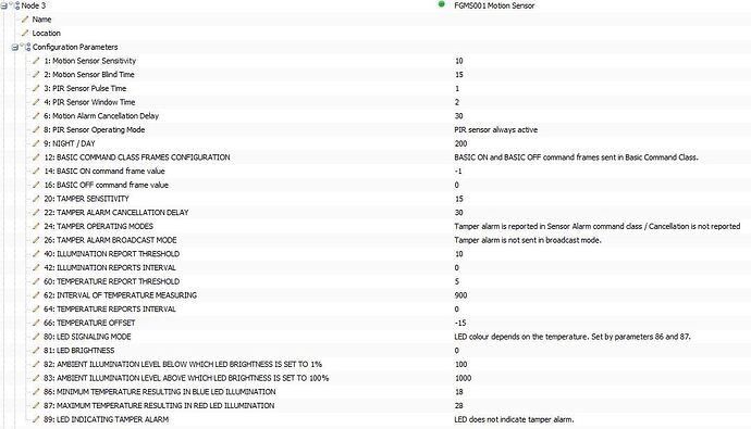

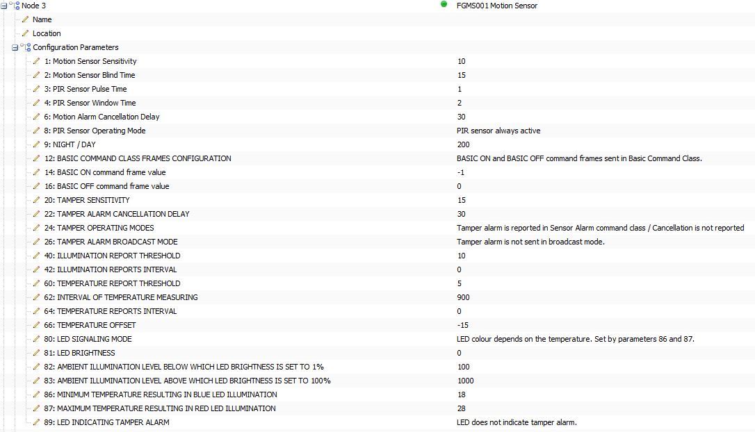

No, it’s not. My FGMS001 is active since about 6 months now and battery level has dropped to 92%.
In the screenshot you can see my configuration settings, wakeup interval is set to 7200.
