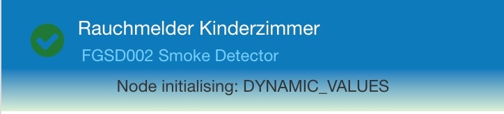

Yesterday I updated my snapshot release from #683 to 698. In #683 I had both sensors successfully integrated. Just out of curiosity I deleted the things and xml-files for both of my smoke sensors with the new build and re-added them.
They were discovered correctly as smoke sensor, but the initialization doesn’t seem to complete. About 18 hours later I still do not have new xml files. They woke up automatically and I also woke up one of them manually several times. And according to Habmin they are stuck at DYNAMIC VALUES:
According to the event log, I do get updates from the temperature channel. The other channels of course are quite non-operational as long as there isn’t some fire… :wink:
Could this be related to the recent changes of the polling mechanism?

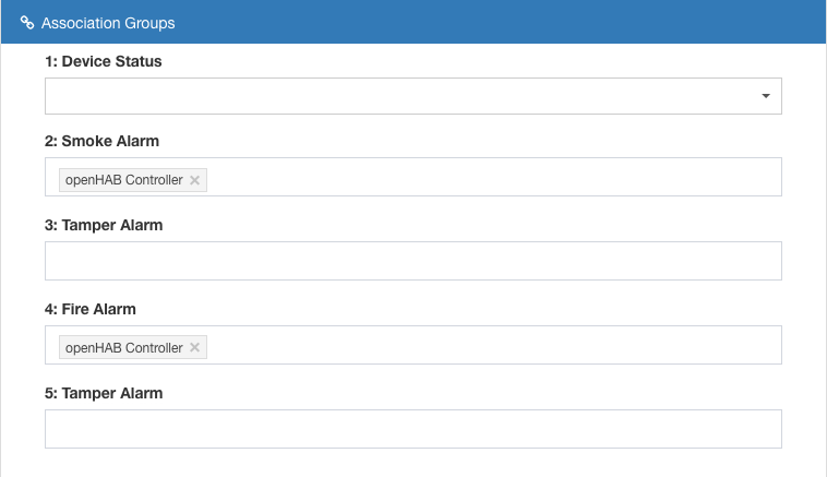

Here is the log @chris. I deleted the thing (node 13) right before turning DEBUG on. Then I re-added it. I made a couple of manual wakeups (about 5 or 6) after that. Furthermore I changed the association group device status to “openhab controller”, since it was empty after re-adding. It went to “pending…” but even after the manual wakeups, it didn’t complete.

So, is this already working for you? I’m going crazy with this, can’t get it to work. I can receive temperature data but no heat_alarm. I’m using OH2 2.1.0-1, with an item defined like this:
Switch alarma_temperatura_cocina "Alarma Temperatura Cocina [%s]" <siren> (sensor, temperatura, cocina, zwave, alarma) { channel="zwave:device:controller:node8:alarm_heat" }
I’ve tried everything I saw on the forums: Adding OH2 controller to association groups 2&4, adding the “respond_to_basic=true” (which seems not to be required anymore with OH2), etc. But even if the alarm is signalled visually (led blinks) I never get the notification on OH2.
Any clue of what might be wrong or anything else that can be tried?

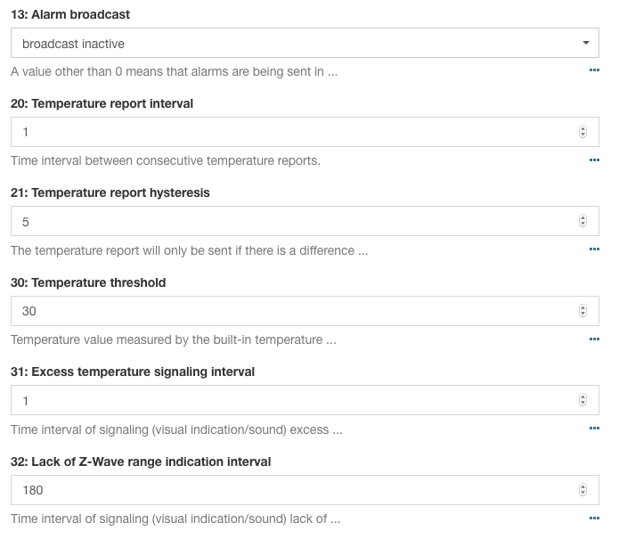

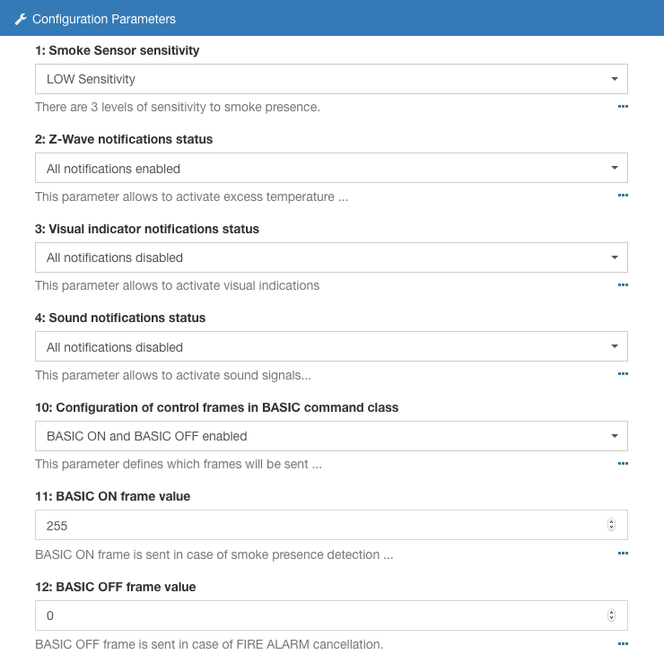

PS: Configuration of the thing below.
