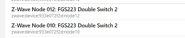

I saw something really strange (I am not sure if it was also the same before).
After the scan I can see two nodes (10,12) , both appears as FGS223 (see pic).

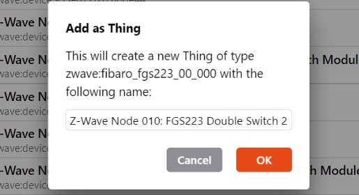

When I click to add 10, I can see in that the thing type will be fgs223_00_000 , and when I add 12 the thing type is fgs213_00_000 (see pics in the next posts as I can’t upload more than one)

I think there is some issue with the device detection, first you can see that the two devices have same ID etc’ but the XML are different which I can’t explain.
When I re-scan the Aeotec , it looks like both are identified with similar type:
