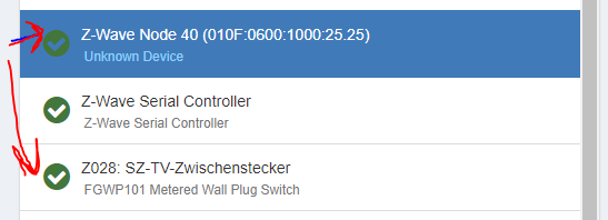

I have on (ID:28) that i dont deleted. This one works in Habmin but i get the same error in the Log.
The one (ID:40) i deleted is found as unknown.
But in the log the error is the same:
10:15:45.004 [WARN ] [zwave.discovery.ZWaveDiscoveryService] - NODE 40: Device discovery could not resolve to a thingType! 010F:0600:1000::25.25
10:15:45.039 [WARN ] [zwave.discovery.ZWaveDiscoveryService] - NODE 28: Device discovery could not resolve to a thingType! 010F:0600:1000::25.25
If you have one device with two different node id’s, you need to get rid of one: go to advanced settings in HABmin, set node to failed and then remove it from the controller.
Sometimes this has to be done more than once and I remember one case where I had to restart openHAB to remove the wrong node.
No …i have two WallPlugs.
Both had the Log Failure
I deleted Node 40 for readding to stop this failure.
After this it shows the Node as Unknown Device.
I tried to delete both but now after search both are Unknown :frowning:
Its not the same device. I have two WallPlugs
Ahh, then forget my advice.
Then your problem is some kind of strange :sunglasses:
Deleting the two things and reading them should solve that …

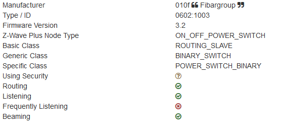

@chris
can you please have a short look, yesterday received another 102-Fibaro Wall Plug, but its not recognized after waiting for some hours and re-incluion…
Here are the following details from Habmin
Thanks a lot,
Norbert
That one has a new type and id which was not in the database. I’ve added it.
http://www.cd-jackson.com/index.php/zwave/zwave-device-database/zwave-device-list/devicesummary/513
