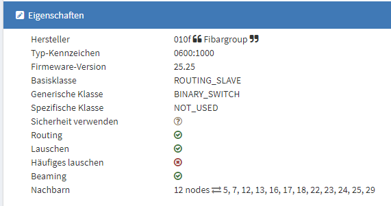

Hi all,
I was using domoticz, but had some communication issues (sometimes switch commands timed out), so I decided to try openHAB. Looks like it is working fine (although HABmin does not work on edge, but that’s another story), except for two wall plug swtiches that I have: Fibaro FGWPE/F 102 ZW5. When it comes up in the “INBOX” it comes up as unkown devcice. In HABmin manufacturer is empty, type/id is empty, firmware says version 0.0, the rest of the info is ok I think.
If I look at the device on domoticz it gives 0x0602 0x1001, zwave+ version 1, library version 3, protocol version 4.05, application version 3.05.
Not sure how to try to fix it. Any suggestions?

Probably there is something wrong with the communication with the device otherwise the manufacturer information etc would not be 0 or empty.
Check the logs to see what is happening - maybe use debug mode to see what’s going on. There is an online log viewer here that might also help.

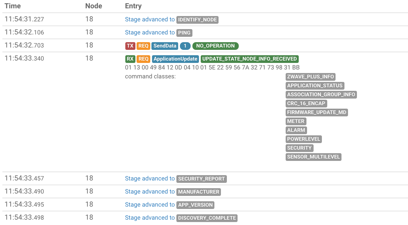

Ok I did that, got the following (after reboot), I took out other stuff not related to node 18. Not sure how to proceed. Looks like it is communicating, sort of, responds to a ping.
Thanks,
Ramon
2018-12-31 11:53:30.558 [DEBUG] [ding.zwave.handler.ZWaveThingHandler] - NODE 18: Handler disposed. Unregistering listener.
2018-12-31 11:53:30.578 [DEBUG] [l.initialization.ZWaveNodeSerializer] - NODE 18: Serializing to file /var/lib/openhab2/zwave/network_fef20e8f__node_18.xml
2018-12-31 11:54:26.838 [DEBUG] [ding.zwave.handler.ZWaveThingHandler] - NODE 18: MANUFACTURER not set
2018-12-31 11:54:30.134 [DEBUG] [age.SerialApiGetInitDataMessageClass] - NODE 18: Node found
2018-12-31 11:54:30.244 [DEBUG] [ve.internal.protocol.ZWaveController] - NODE 18: Init node thread start
2018-12-31 11:54:30.812 [DEBUG] [l.initialization.ZWaveNodeSerializer] - NODE 18: Serializing from file /var/lib/openhab2/zwave/network_fef20e8f__node_18.xml
2018-12-31 11:54:31.059 [WARN ] [ve.internal.protocol.ZWaveController] - NODE 18: Restore from config: Error. Data invalid, ignoring config.
2018-12-31 11:54:31.060 [DEBUG] [alization.ZWaveNodeInitStageAdvancer] - NODE 18: Starting initialisation from EMPTYNODE
2018-12-31 11:54:31.225 [DEBUG] [ve.internal.protocol.ZWaveController] - NODE 18: Init node thread finished
2018-12-31 11:54:31.227 [DEBUG] [alization.ZWaveNodeInitStageAdvancer] - NODE 18: Node advancer - advancing to IDENTIFY_NODE
2018-12-31 11:54:31.230 [DEBUG] [alization.ZWaveNodeInitStageAdvancer] - NODE 18: Node advancer: Initialisation starting
018-12-31 11:54:31.802 [DEBUG] [rialmessage.IdentifyNodeMessageClass] - NODE 18: ProtocolInfo
2018-12-31 11:54:31.804 [DEBUG] [rialmessage.IdentifyNodeMessageClass] - NODE 18: Listening = true
2018-12-31 11:54:31.806 [DEBUG] [rialmessage.IdentifyNodeMessageClass] - NODE 18: Routing   = true
2018-12-31 11:54:31.810 [DEBUG] [rialmessage.IdentifyNodeMessageClass] - NODE 18: Beaming   = true
2018-12-31 11:54:31.823 [DEBUG] [rialmessage.IdentifyNodeMessageClass] - NODE 18: Version   = 4
2018-12-31 11:54:31.825 [DEBUG] [rialmessage.IdentifyNodeMessageClass] - NODE 18: FLIRS     = false
2018-12-31 11:54:31.828 [DEBUG] [rialmessage.IdentifyNodeMessageClass] - NODE 18: Security  = false
2018-12-31 11:54:31.830 [DEBUG] [rialmessage.IdentifyNodeMessageClass] - NODE 18: Max Baud  = 40000
2018-12-31 11:54:31.847 [DEBUG] [rialmessage.IdentifyNodeMessageClass] - NODE 18: Basic    = BASIC_TYPE_ROUTING_SLAVE
2018-12-31 11:54:31.849 [DEBUG] [rialmessage.IdentifyNodeMessageClass] - NODE 18: Generic  = GENERIC_TYPE_SWITCH_BINARY
2018-12-31 11:54:31.852 [DEBUG] [rialmessage.IdentifyNodeMessageClass] - NODE 18: Specific = SPECIFIC_TYPE_POWER_SWITCH_BINARY
2018-12-31 11:54:31.855 [DEBUG] [tocol.commandclass.ZWaveCommandClass] - NODE 18: Creating new instance of command class COMMAND_CLASS_NO_OPERATION
2018-12-31 11:54:31.859 [DEBUG] [tocol.commandclass.ZWaveCommandClass] - NODE 18: Command class COMMAND_CLASS_NO_OPERATION, endpoint 0 created
2018-12-31 11:54:31.861 [DEBUG] [tocol.commandclass.ZWaveCommandClass] - NODE 18: Version = 1, version set. Enabling extra functionality.
2018-12-31 11:54:31.865 [DEBUG] [ng.zwave.internal.protocol.ZWaveNode] - NODE 18: Adding command class COMMAND_CLASS_NO_OPERATION to the list of supported command classes.
2018-12-31 11:54:31.867 [DEBUG] [tocol.commandclass.ZWaveCommandClass] - NODE 18: Creating new instance of command class COMMAND_CLASS_BASIC
2018-12-31 11:54:31.870 [DEBUG] [tocol.commandclass.ZWaveCommandClass] - NODE 18: Command class COMMAND_CLASS_BASIC, endpoint 0 created
2018-12-31 11:54:31.872 [DEBUG] [ng.zwave.internal.protocol.ZWaveNode] - NODE 18: Adding command class COMMAND_CLASS_BASIC to the list of supported command classes.
2018-12-31 11:54:32.097 [DEBUG] [alization.ZWaveNodeInitStageAdvancer] - NODE 18: Node Init response (0) org.openhab.binding.zwave.internal.protocol.ZWaveTransactionResponse@1279a46
2018-12-31 11:54:32.101 [DEBUG] [alization.ZWaveNodeInitStageAdvancer] - NODE 18: Node Init transaction completed with response COMPLETE
2018-12-31 11:54:32.099 [DEBUG] [nal.protocol.ZWaveTransactionManager] - Received msg (1): Message: class=null[0], type=ACK[2], dest=255, callback=0, payload=
2018-12-31 11:54:32.105 [DEBUG] [nal.protocol.ZWaveTransactionManager] - lastTransaction TID 9: [WAIT_RESPONSE] priority=Controller, requiresResponse=true, callback: 0
2018-12-31 11:54:32.106 [DEBUG] [alization.ZWaveNodeInitStageAdvancer] - NODE 18: Node advancer - advancing to PING
2018-12-31 11:54:32.110 [DEBUG] [ndclass.ZWaveNoOperationCommandClass] - NODE 18: Creating new message for command NO_OPERATION_PING
2018-12-31 11:54:32.116 [DEBUG] [nal.protocol.ZWaveTransactionManager] - Received msg: ACK
2018-12-31 11:54:32.117 [DEBUG] [alization.ZWaveNodeInitStageAdvancer] - NODE 18: ZWaveCommandClassTransactionPayload - send to node
2018-12-31 11:54:32.118 [DEBUG] [nal.protocol.ZWaveTransactionManager] - Received msg (0): Message: class=IdentifyNode[65], type=Response[1], dest=255, callback=0, payload=93 16 01 02 02 0$
2018-12-31 11:54:32.121 [DEBUG] [nal.protocol.ZWaveTransactionManager] - lastTransaction TID 9: [WAIT_RESPONSE] priority=Controller, requiresResponse=true, callback: 0
2018-12-31 11:54:32.123 [DEBUG] [nal.protocol.ZWaveTransactionManager] - Checking outstanding transactions: 1
2018-12-31 11:54:32.124 [DEBUG] [nal.protocol.ZWaveTransactionManager] - Last transaction: TID 9: [WAIT_RESPONSE] priority=Controller, requiresResponse=true, callback: 0
2018-12-31 11:54:32.123 [DEBUG] [ng.zwave.internal.protocol.ZWaveNode] - NODE 18: SECURITY not supported
2018-12-31 11:54:32.130 [DEBUG] [ng.zwave.internal.protocol.ZWaveNode] - NODE 18: Command Class COMMAND_CLASS_NO_OPERATION is NOT required to be secured
2018-12-31 11:54:32.133 [DEBUG] [nal.protocol.ZWaveTransactionManager] - NODE 18: sendTransaction org.openhab.binding.zwave.internal.protocol.transaction.ZWaveCommandClassTransactionPayloa$
2018-12-31 11:54:32.136 [DEBUG] [ve.internal.protocol.ZWaveController] - Incoming Message: Message: class=IdentifyNode[65], type=Response[1], dest=255, callback=0, payload=93 16 01 02 02 0$
2018-12-31 11:54:32.136 [DEBUG] [nal.protocol.ZWaveTransactionManager] - NODE 18: Adding to device queue
2018-12-31 11:54:32.138 [DEBUG] [nal.protocol.ZWaveTransactionManager] - NODE 18: Added 15 to queue - size 2
2018-12-31 11:54:32.138 [DEBUG] [rialmessage.IdentifyNodeMessageClass] - NODE 1: ProtocolInfo
2018-12-31 11:54:32.140 [DEBUG] [nal.protocol.ZWaveTransactionManager] - Transaction SendNextMessage 1 out at start. Holdoff false.
2018-12-31 11:54:32.703 [DEBUG] [ing.zwave.handler.ZWaveSerialHandler] - NODE 18: Sending REQUEST Message = 01 08 00 13 12 01 00 25 01 D3
The log is a bit short, but there is currently no communication with the device. Is there anything more in the log (I expect so)?
The log was growing pretty fast, so I stopped it. I can start it again if that helps, but well if it is not communicating then I guess it will also not show anything else?
I also tried to exclude the node and delete the node from teh controller, but that does not appear to work. Seems along the way I made now few ghost nodes as well, which I also cannot delete.
I can try a hard reset of the controller, see if that helps. The weird thing remains that domoticz is communicating with it.
Thanks,
Ramon
Well, you stopped the log before the binding started to communicate with it, so I can’t confirm that from the log, although it is likely the case from what we’ve seen…
There was some more actually (see below).
I think it is communicating as it says NODE 18: Node advancer: APP_VERSION - VERSION not supported
Thanks,
Ramon

It’s pretty hard to see what’s happening - this is what the log looks like -:
It doesn’t show a received frame, but it then seems to skip straight to the end of the initialisation with very little being logged.
Maybe there’s an exception being thrown that’s not logged, or maybe it’s related to the crypto exception -:
I’m not sure what would cause this - you could make sure that there is a network key set in the controller. In theory this should be set automatically, but if there was something strange with the binding initialisation, maybe this hasn’t been configured.
Otherwise there’s not a lot to go on from the log :frowning:
Ok I tried a hard reset of the controller and that seemed to work.
So I guess the issue is resolved. Now all the work of re-including everything…
Thanks for the help chris.
