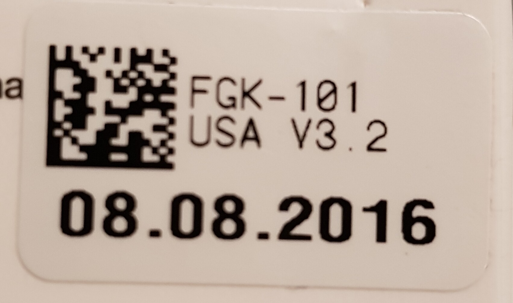

I think I found my mistake. The sensor was not available in EU. So I bought the sensor with amazon in US
see:
In the US they use another frequency-band as zwave in EU which is not compatible.
