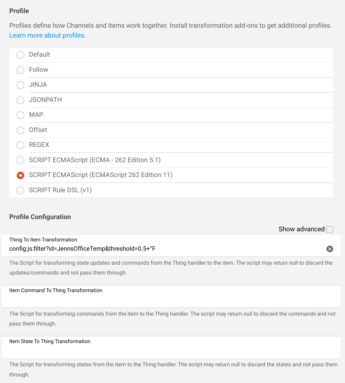

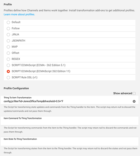

I have this defined through the UI as a transform named “Filter”. A couple of examples:
config:js:filter?id=JennsOfficeTemp&threshold=0.5+°F
config:js:filter?id=MainFloorHumidity&threshold=0.5+%25
The id provides a unique ID to this rule which is used by the logger and to keep the values stored in the cache separate. Even when applied to multiple Items, the same instance of the transform is reused across them all. Without the id the values from one use will override the values from the others every time it runs. The id keeps the last values stored in the cache separate so make sure to use a unique value (the name of the Item makes a good choice).
The threshold is how much the value must have changed since the last reported change before the new value is returned. The units of the threshold should be compatible with the unit reported by the Channel.
Notice the space and 5 are encoded with URL encoding above. It might work to just \ escape them or use %% but I only tried this approach.
