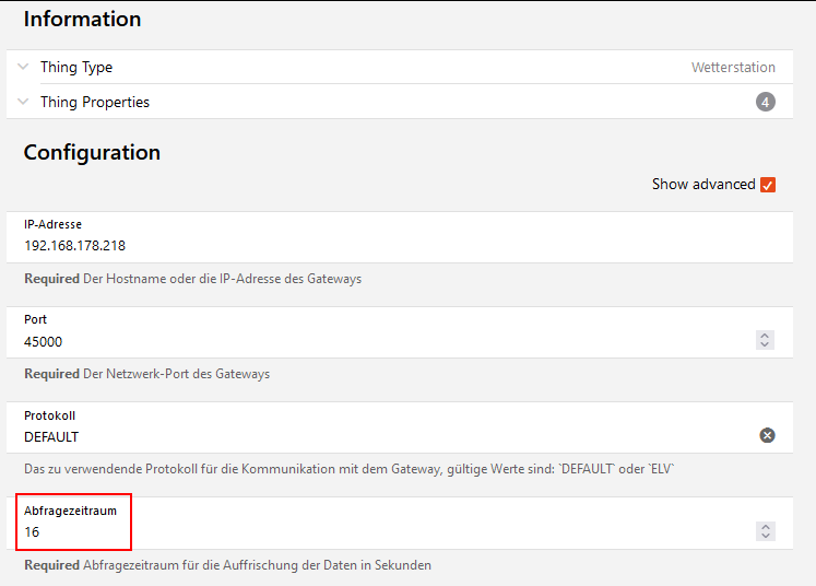

Yes, I did that, unfortunately no change. The view seems to change in time with the refresh time

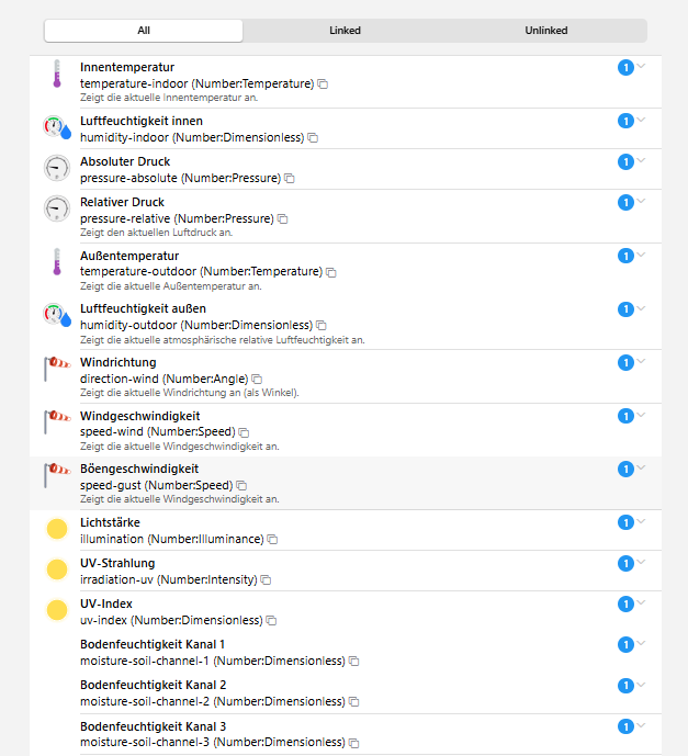

It happened to me that all channels disappeared after a refresh time and reappeared after the next one, cyclically. I had to delete the thing, purge links and then recreate it.
I have noticed this behavior myself, all channels disappear and then reappear.
In the meantime, there are “Health issues (19)” and 19 orphan links
I have only noticed this behavior since version 4.2
I seem to have been able to solve the problem today.
Apparently you can’t just add sensors without rebuilding the weather station!
I deleted all items and things from the weather station and restarted OH. Then I created the weather station thing again. The “leaf moisture” channel was there immediately. I was also offered the “outdoor unit” and “leaf moisture sensor” things. Both things only with the “signal strength” and “battery status” channels.

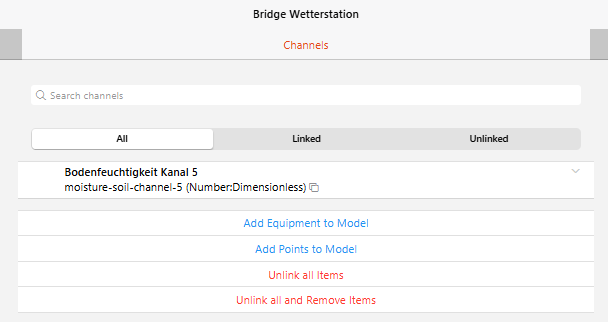

I’ve had the same or a similar problem since yesterday.
OH 4.3.5
WH2650 FW 1.7.8
A WH51 was put into operation (only the battery inserted).
Since then, the channels associated with the gateway have been jumping back and forth between the weather station and the one sensor.
The only thing that helped was to put the sensor out of operation again.
I have already tried the following:
Restarting the gateway and Openhab
Activating and deactivating the gateway in OA
Any other ideas or anyone who has also experienced this phenomenon and found a solution?
When it happened something similar to my installation, some time ago, I uninstalled and reinstalled the things. Don’t remember if I also cleaned cache in between.
You could try to set up temporarily a new installation with only that binding
Clean cache or/and restart didn’s help.
Reinstalling the binding solved the problem. Thank you very much.
Unfortunately, the same weather station then appears under a new UID and all channels have to be relinked.
The old UID of the weather station remains online and continues to provide values, but jumps back and forth as described above.
So it seems to me to be a problem with the binding.
