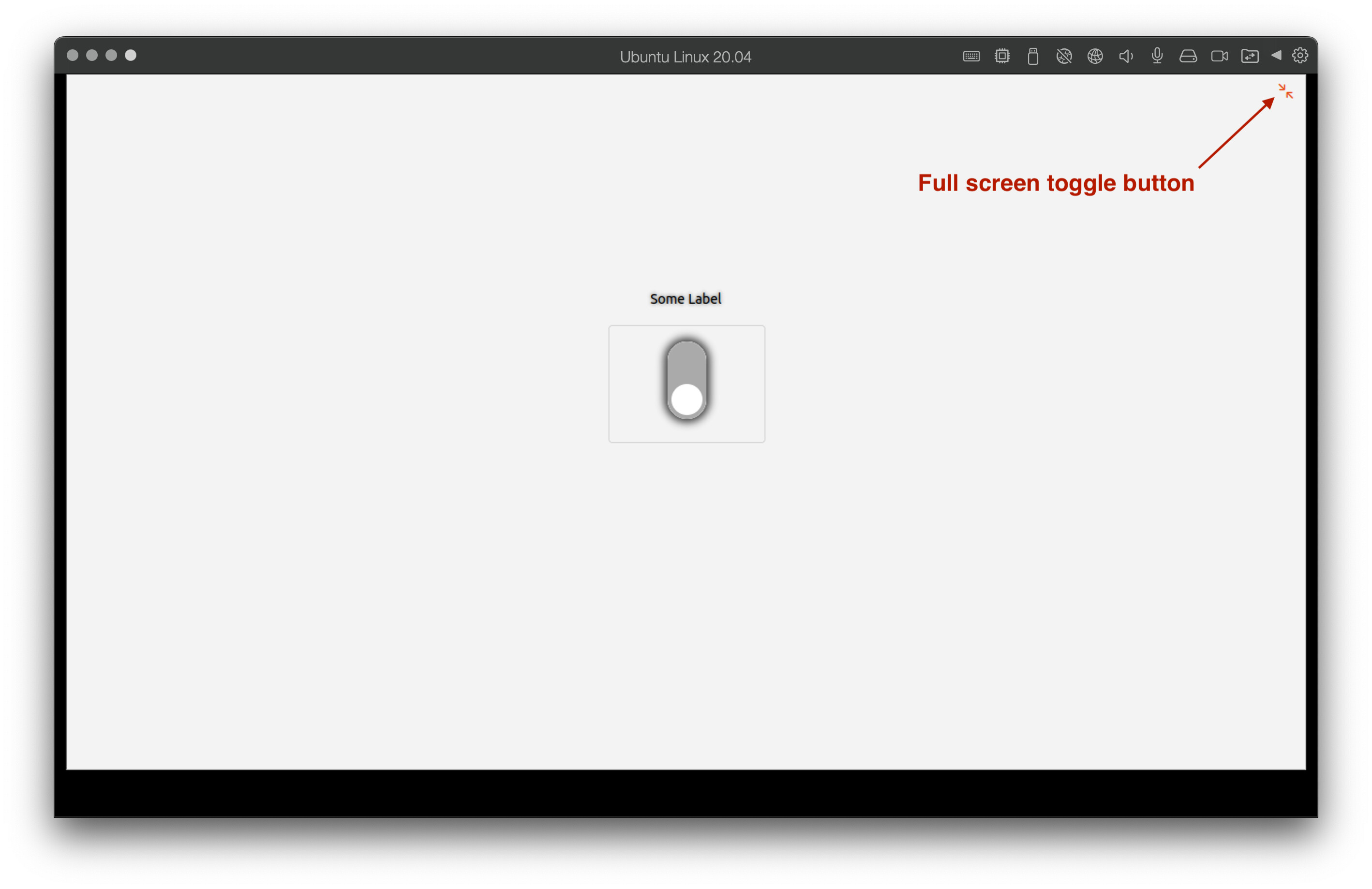

The goal is to have a the UI on a wall mounted tablet (running Ubuntu 20.04). I can have FireFox launched in kiosk mode and it properly takes the “full screen”. However, the page still shows the top bar (with the hamburger button and page label) as well as the icon for full screen mode, which works when clicked.
How can I launch the page directly in full screen mode with no icons to toggle full screen? I could not find anything in the documentation making references to this, which I assume it is something very basic.
While at it, during development, I’m using dark mode, which is what I want. However, when rendered on the Ubuntu VM, it comes up in light mode. How to programmatically force dark mode?
(Don’t mind the frame. This is a VM with the same size as the tablet as it is a lot easier to develop with it rather than going back and forth to the tablet)

Sorry, my bad in using wrong nomenclature. I’m using “Fixed Canvas” within “Fixed Layout”. I now did notice there is indeed a button to show/not show the full screen button when in Fixed Grid but that same is not true for Fixed Canvas. Given my screens are static and all the same, I picked Fixed Canvas so I could precisely place and size items. Is there a way to hide the icon when using Fixed Canvas?

I’m not aware of one. In addition, as the full screen link is, I believe, a javascript function, I don’t think there’s anyway to load the page directly to it.

Found a work around by extrapolating a solution to a different problem given by @JustinG
The source for the FullScreen button is here (the lines might change if the file changes):
While looking at, basically all posts by @JustinG, I bumped into a solution to remove the border of a fixed grid and added code to hide the fullscreen button:
  label:        Foo
  fixedType:    canvas
  gridEnable:   true
  layoutType:   fixed
  scale:        false
  screenHeight: 1080
  screenWidth:  1920
  hideNavbar:   true
  hideSidebarIcon: true
  stylesheet: >
    .oh-canvas-layout-container div img {
      visibility: hidden;
    .fullscreen-icon {
      visibility: hidden;
The above does both. Hides the white border and the full screen button.
