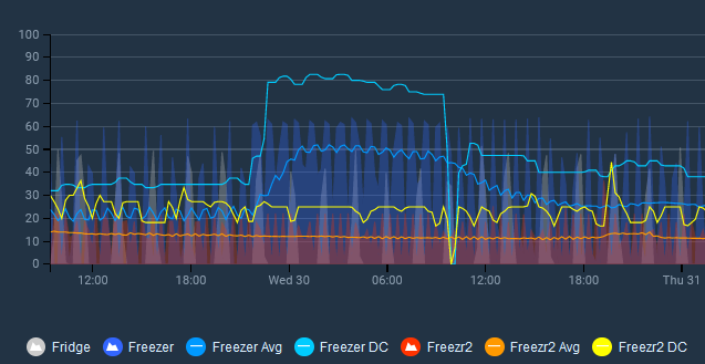

I measure duty cycle, i.e. the percentage of time the freezer cooling engine is on. By looking at power consumption over time, I noticed that the freezer turns on the cooling engine at more or less regular intervals, but the duration of each “engine on” event increases as it needs to cope with an open door. So the rule detects when the freezer turns on and when it turns off, and divides the time form on to off by the time from on to next on. It raises an alarm when the duty cycle goes above a certain threshold. The details of the implementation are described below. This works well, as shown in the following chart.
In the example shown above, the door of the main freezer was not completely closed, all night, which I didn’t notice until mid-morning. Obviously, this was before I had implemented an alarm signal. The averaged energy consumption (medium blue line, “Freezer Avg”) rises slowly, over several hours, and drops even more slowly after I closed the door in the morning. The calculated duty cycle (light blue line, “Freezer DC”) rises and falls much more quickly, making this a better candidate for triggering an alarm.
