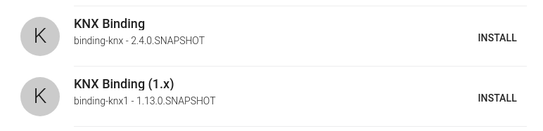

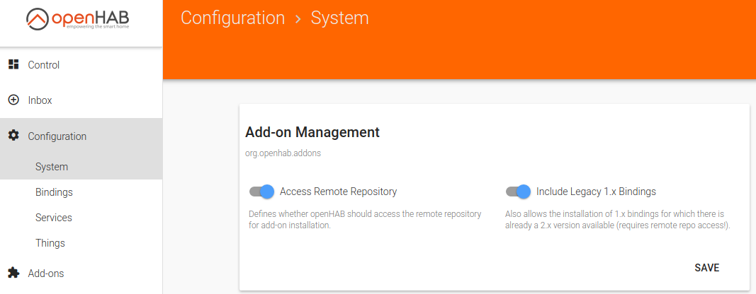

It should show up in the Bindings list after enabling “Include Legacy 1.x Bindings” in the System Configuration and clicking the “Save” button.
Configuration > System
Add-ons > Bindings
