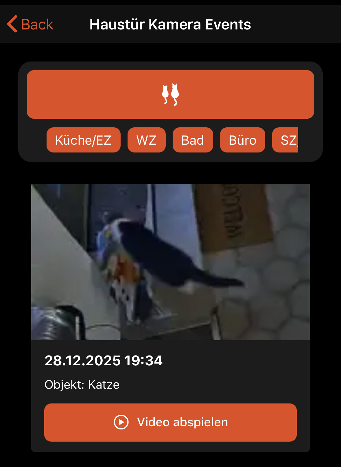

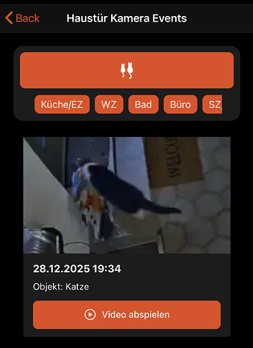

I built an integration that:
  • Tracks Frigate events via MQTT (last 30 per camera)

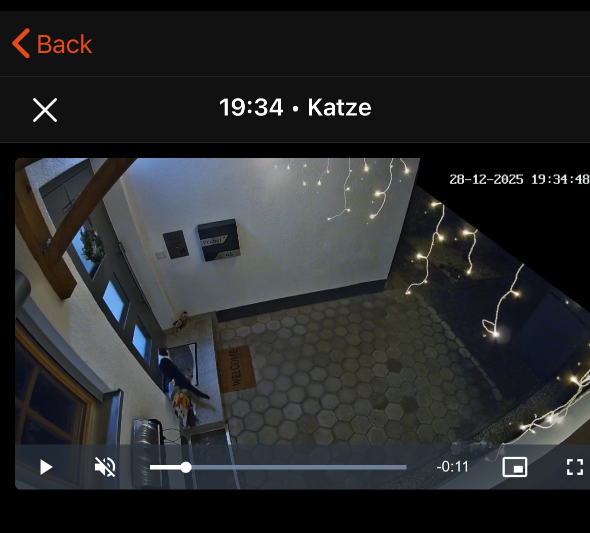

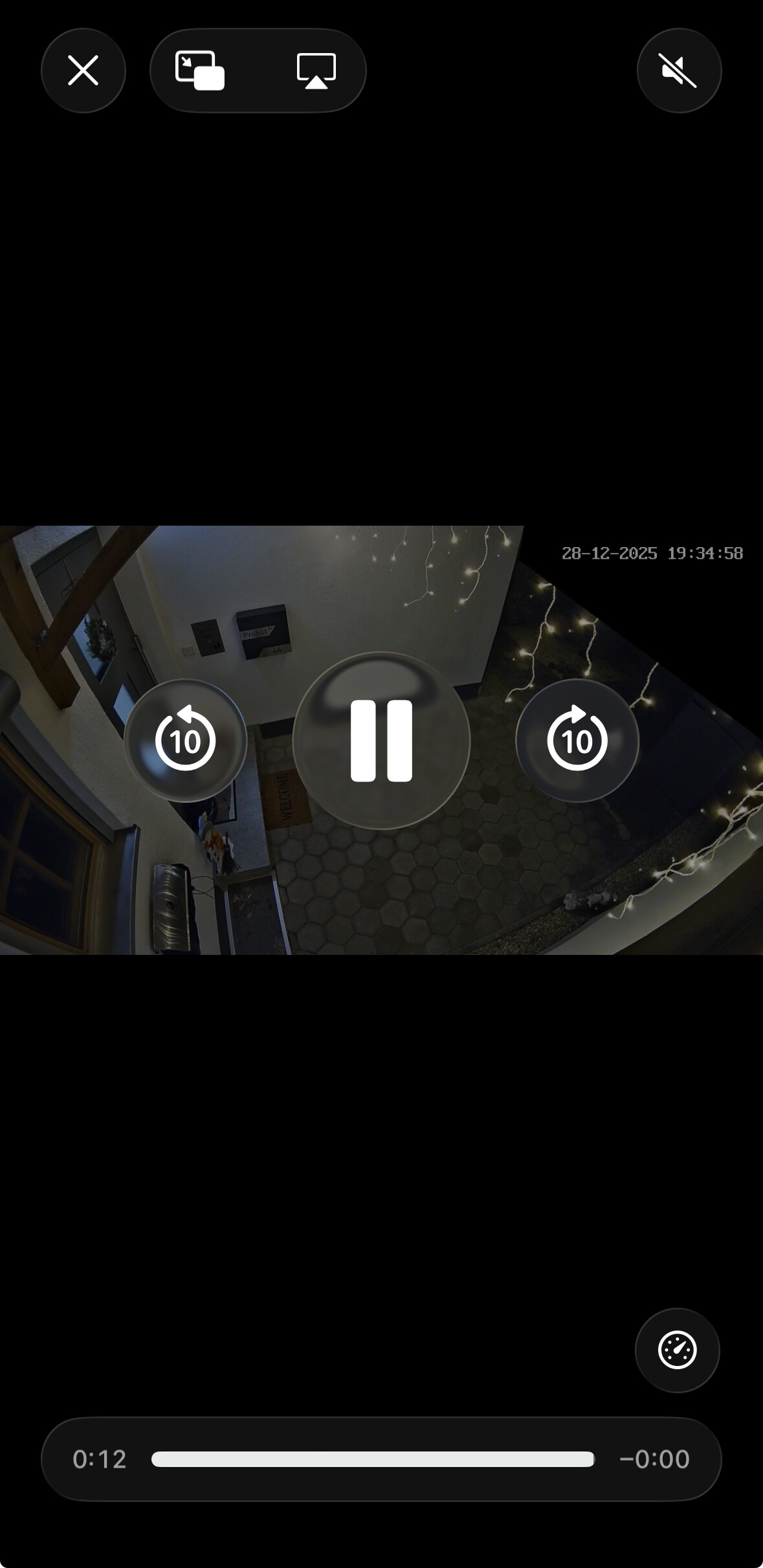

  • Automatically downloads HLS videos from the Frigate API to NAS
  • Shows nice widgets with thumbnails and direct video playback
  • Automatically deletes old recordings
Works for me with 8 cameras, should work with any number.

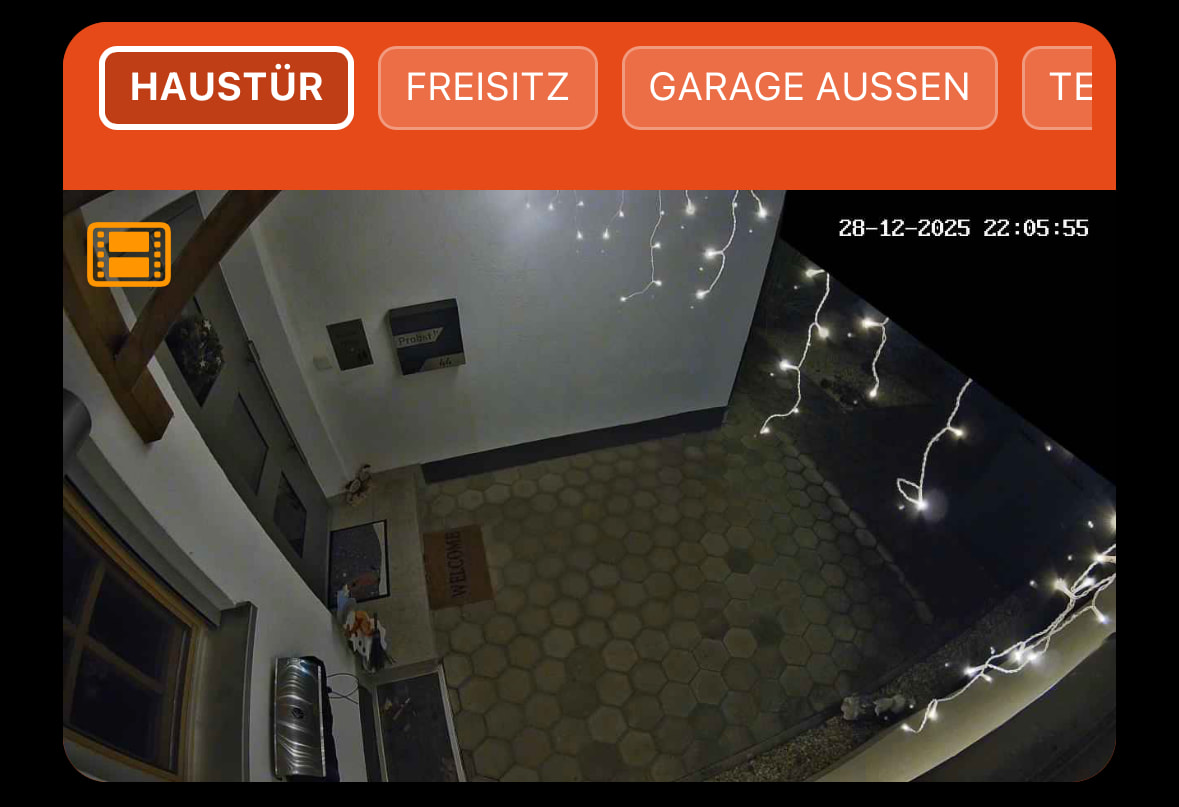

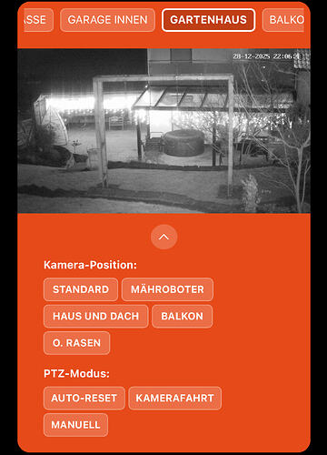

4. Widgets
I built 3 widgets. The code is included below - you can easily extend them to more cameras/events or try using oh-repeater (I couldn’t get it to work reliably, but maybe you’ll have better luck!).
Widget 1: CameraSnapshotHistory_Frigate_v1
Shows overview of all cameras with event count badges. This example shows 3 cameras - just copy the pattern for more.

  default:
    # Camera 1
    - component: f7-card
        style:
          margin-bottom: 15px
        visible: "=props.camera1ImageItem ? true : false"
        default:
          - component: f7-card-content
              style:
                padding: 0
              default:
                - component: oh-link
                    action: navigate
                    actionPage: "=props.camera1PageUid"
                    default:
                      - component: f7-block
                          style:
                            margin: 0
                            padding: 0
                            position: relative
                          default:
                            - component: oh-image
                                refreshInterval: "=props.refreshRate || 5000"
                                style:
                                  aspect-ratio: 16/9
                                  display: block
                                  object-fit: cover
                                  width: 100%
                                url: "='/rest/items/' + props.camera1ImageItem + '/state'"
                            - component: f7-badge
                                style:
                                  background: var(--f7-theme-color)
                                  border-radius: 20px
                                  font-size: 14px
                                  font-weight: bold
                                  padding: 8px 16px
                                  position: absolute
                                  right: 12px
                                  top: 12px
                                  z-index: 10
                                text: "=items[props.camera1ClipHistoryLengthItem].state || '0'"
                          style:
                            padding: 12px 15px
                          default:
                            - component: Label
                                style:
                                  font-size: 18px
                                  font-weight: bold
                                text: "=props.camera1Name"
    # Camera 2
        style:
          margin-bottom: 15px
        visible: "=props.camera2ImageItem ? true : false"
        default:
              style:
                padding: 0
              default:
                    action: navigate
                    actionPage: "=props.camera2PageUid"
                    default:
                          style:
                            margin: 0
                            padding: 0
                            position: relative
                          default:
                                style:
                                  aspect-ratio: 16/9
                                  display: block
                                  object-fit: cover
                                  width: 100%
                                url: "='/rest/items/' + props.camera2ImageItem + '/state'"
                                style:
                                  border-radius: 20px
                                  font-size: 14px
                                  font-weight: bold
                                  padding: 8px 16px
                                  position: absolute
                                  right: 12px
                                  top: 12px
                                  z-index: 10
                                text: "=items[props.camera2ClipHistoryLengthItem].state || '0'"
                          style:
                            padding: 12px 15px
                          default:
                            - component: Label
                                style:
                                  font-size: 18px
                                  font-weight: bold
                                text: "=props.camera2Name"
    # Camera 3
        style:
          margin-bottom: 15px
        visible: "=props.camera3ImageItem ? true : false"
        default:
              style:
                padding: 0
              default:
                    action: navigate
                    actionPage: "=props.camera3PageUid"
                    default:
                          style:
                            margin: 0
                            padding: 0
                            position: relative
                          default:
                                style:
                                  aspect-ratio: 16/9
                                  display: block
                                  object-fit: cover
                                  width: 100%
                                url: "='/rest/items/' + props.camera3ImageItem + '/state'"
                                style:
                                  border-radius: 20px
                                  font-size: 14px
                                  font-weight: bold
                                  padding: 8px 16px
                                  position: absolute
                                  right: 12px
                                  top: 12px
                                  z-index: 10
                                text: "=items[props.camera3ClipHistoryLengthItem].state || '0'"
                          style:
                            padding: 12px 15px
                          default:
                            - component: Label
                                style:
                                  font-size: 18px
                                  font-weight: bold
                                text: "=props.camera3Name"
Widget 2: EventBrowser_Frigate_v1
Shows event list with thumbnails. This example shows 5 events - extend by copying the pattern or try using oh-repeater.
yaml
uid: EventBrowser_Frigate_v1
tags: []
props:
  parameters:
    - description: Technical name (e.g. 'front_door', 'patio')
      label: Camera Name
      required: true
      type: TEXT
    - description: Display name (e.g. 'Front Door', 'Patio')
      label: Camera Display Name
      required: true
      type: TEXT
    - context: item
      description: Item with event IDs (comma-separated)
      label: Clip History Item
      required: true
      type: TEXT
    - context: item
      description: Item with metadata (|~| separated)
      label: Clip History Meta Item
      required: true
      type: TEXT
    - context: item
      description: Item with event count
      label: Clip History Length Item
      required: true
      type: TEXT
timestamp: Dec 28, 2025, 10:00:00 PM
component: f7-block
  style:
    margin: 0
    padding: 10px
  default:
    # Empty state
        style:
          color: var(--f7-text-color)
          padding: 60px 20px
          text-align: center
        visible: =items[props.clipHistoryLengthItem].state == 0
        default:
          - component: Label
              style:
                font-size: 64px
                margin-bottom: 15px
              text: 📹
          - component: Label
              style:
                color: var(--f7-text-color-secondary)
                display: block
                font-size: 16px
              text: No events stored
    # Event list
        style:
          margin: 0
          padding: 0
        visible: =items[props.clipHistoryLengthItem].state > 0
        default:
          # Event 0
              style:
                margin-bottom: 15px
              visible: =items[props.clipHistoryLengthItem].state >= 1
              default:
                    style:
                      padding: 0
                    default:
                          style:
                            margin: 0
                            padding: 0
                            position: relative
                          default:
                                style:
                                  aspect-ratio: 16/9
                                  background: "#000"
                                  display: block
                                  object-fit: cover
                                  width: 100%
                                url: ='/static/ipcam/' + props.cameraName + '/hls/' + items[props.clipHistoryMetaItem].state.split('|~|')[0].split('|')[2].substring(0,10) + '/' + items[props.clipHistoryItem].state.split(',')[0] + '/thumbnail.jpg'
                          style:
                            padding: 12px 15px
                          default:
                            - component: Label
                                style:
                                  display: block
                                  font-size: 16px
                                  font-weight: bold
                                  margin-bottom: 8px
                                text: =items[props.clipHistoryMetaItem].state.split('|~|')[0].split('|')[2].substring(8,10) + '.' + items[props.clipHistoryMetaItem].state.split('|~|')[0].split('|')[2].substring(5,7) + '.' + items[props.clipHistoryMetaItem].state.split('|~|')[0].split('|')[2].substring(0,4) + ' ' + items[props.clipHistoryMetaItem].state.split('|~|')[0].split('|')[2].substring(11,16)
                            - component: Label
                                style:
                                  display: block
                                  font-size: 14px
                                  margin-bottom: 12px
                                text: "='Object: ' + items[props.clipHistoryMetaItem].state.split('|~|')[0].split('|')[1]"
                                action: popup
                                actionModal: widget:FrigateEventVideoPlayer
                                actionModalConfig:
                                  cameraName: =props.cameraName
                                  eventId: =items[props.clipHistoryItem].state.split(',')[0]
                                  eventDate: =items[props.clipHistoryMetaItem].state.split('|~|')[0].split('|')[2].substring(0,10)
                                  eventLabel: =items[props.clipHistoryMetaItem].state.split('|~|')[0].split('|')[1]
                                  eventTime: =items[props.clipHistoryMetaItem].state.split('|~|')[0].split('|')[2].substring(11,16)
                                style:
                                  align-items: center
                                  border-radius: 8px
                                  color: white
                                  display: flex
                                  font-weight: 500
                                  height: 44px
                                  justify-content: center
                                  text-decoration: none
                                default:
                                  - component: f7-icon
                                      f7: play_circle
                                      style:
                                        margin-right: 8px
                                  - component: Label
                                      text: Play Video
          # Event 1
              style:
                margin-bottom: 15px
              visible: =items[props.clipHistoryLengthItem].state >= 2
              default:
                    style:
                      padding: 0
                    default:
                          style:
                            margin: 0
                            padding: 0
                            position: relative
                          default:
                                style:
                                  aspect-ratio: 16/9
                                  background: "#000"
                                  display: block
                                  object-fit: cover
                                  width: 100%
                                url: ='/static/ipcam/' + props.cameraName + '/hls/' + items[props.clipHistoryMetaItem].state.split('|~|')[1].split('|')[2].substring(0,10) + '/' + items[props.clipHistoryItem].state.split(',')[1] + '/thumbnail.jpg'
                          style:
                            padding: 12px 15px
                          default:
                            - component: Label
                                style:
                                  display: block
                                  font-size: 16px
                                  font-weight: bold
                                  margin-bottom: 8px
                                text: =items[props.clipHistoryMetaItem].state.split('|~|')[1].split('|')[2].substring(8,10) + '.' + items[props.clipHistoryMetaItem].state.split('|~|')[1].split('|')[2].substring(5,7) + '.' + items[props.clipHistoryMetaItem].state.split('|~|')[1].split('|')[2].substring(0,4) + ' ' + items[props.clipHistoryMetaItem].state.split('|~|')[1].split('|')[2].substring(11,16)
                            - component: Label
                                style:
                                  display: block
                                  font-size: 14px
                                  margin-bottom: 12px
                                text: "='Object: ' + items[props.clipHistoryMetaItem].state.split('|~|')[1].split('|')[1]"
                                action: popup
                                actionModalConfig:
                                  eventId: =items[props.clipHistoryItem].state.split(',')[1]
                                  eventDate: =items[props.clipHistoryMetaItem].state.split('|~|')[1].split('|')[2].substring(0,10)
                                  eventLabel: =items[props.clipHistoryMetaItem].state.split('|~|')[1].split('|')[1]
                                  eventTime: =items[props.clipHistoryMetaItem].state.split('|~|')[1].split('|')[2].substring(11,16)
                                style:
                                  align-items: center
                                  border-radius: 8px
                                  color: white
                                  display: flex
                                  font-weight: 500
                                  height: 44px
                                default:
                                      f7: play_circle
                                      style:
                                        margin-right: 8px
                                  - component: Label
                                      text: Play Video
          # Events 2-4: Copy pattern above and change indices
          # For more than 5 events, continue the pattern or try using oh-repeater
Widget 3: FrigateEventVideoPlayer
Full-screen video player popup:
yaml
uid: FrigateEventVideoPlayer
tags: []
props:
  parameters:
    - name: cameraName
      label: Camera Name
      type: TEXT
      required: true
    - name: eventId
      label: Event ID
      type: TEXT
      required: true
    - name: eventDate
      label: Event Date (YYYY-MM-DD)
      type: TEXT
      required: true
    - name: eventLabel
      label: Event Label
      type: TEXT
      required: true
    - name: eventTime
      label: Event Time (HH:MM)
      type: TEXT
      required: true
component: f7-page
  style:
    background: black
    height: 100vh
    display: flex
    flex-direction: column
  default:
    - component: f7-navbar
        style:
          background: rgba(0,0,0,0.95)
          flex-shrink: 0
        title:
          - component: f7-nav-title
              style:
                color: white
                font-size: 16px
              title: "=props.eventTime + ' • ' + props.eventLabel"
        left:
          - component: f7-link
              iconF7: xmark
              iconSize: 24
              iconColor: white
              back: true
    - component: oh-video-card
        noBorder: true
        noShadow: true
        style:
          flex: 1
          width: 100%
          height: 100%
          background: black
        url: "='/static/ipcam/' + props.cameraName + '/hls/' + props.eventDate + '/' + props.eventId + '/playlist.m3u8'"
What I learned
HEVC vs H.264
If you use HEVC (H.265):
  • IMPORTANT: Use fMP4/CMAF, NOT MPEG-TS!
  • MPEG-TS with HEVC doesn’t play in most browsers
  • fMP4 works everywhere
That’s why in the ffmpeg command:
-hls_segment_type fmp4
