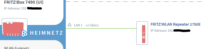

@bbock I have the same issue here, but I think it has nothing to do with meshing, as I have connected
the access points via “lan-bridge” mode to the fritzbox and not via wireless meshing. I only see my mobile phone’s mac address online when directly connected to the fritzbox but not when connect at an access point…

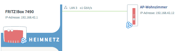

@bernd_d I have connected them as well via Ethernet. But since 6.90, this is also treated as mesh (according to the GUI), which probably affects the internal handling and things like handover.

My GUI only shows active meshing on the Fritzbox Side - not on at the access points (meshing Icon) - as I have it not activated for the access points. Running Firmware 6.92 - but still no MAC address recognition at the access points…
Interesting. I have enabled the mesh feature for the AP.
Unfortunately, either way, presence doesn’t work with 6.90 or newer.
