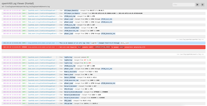

Hi sorry I’m not good at explaining - like this
But not as dark and coloured with your stylish flare
Ooh I see now, you mean color alternating rows in white / dark gray. That’s a nice idea. Will have to play with the code a bit and get back to you!
Yes but probably not dark grey and of course a light alternative on the dark theme

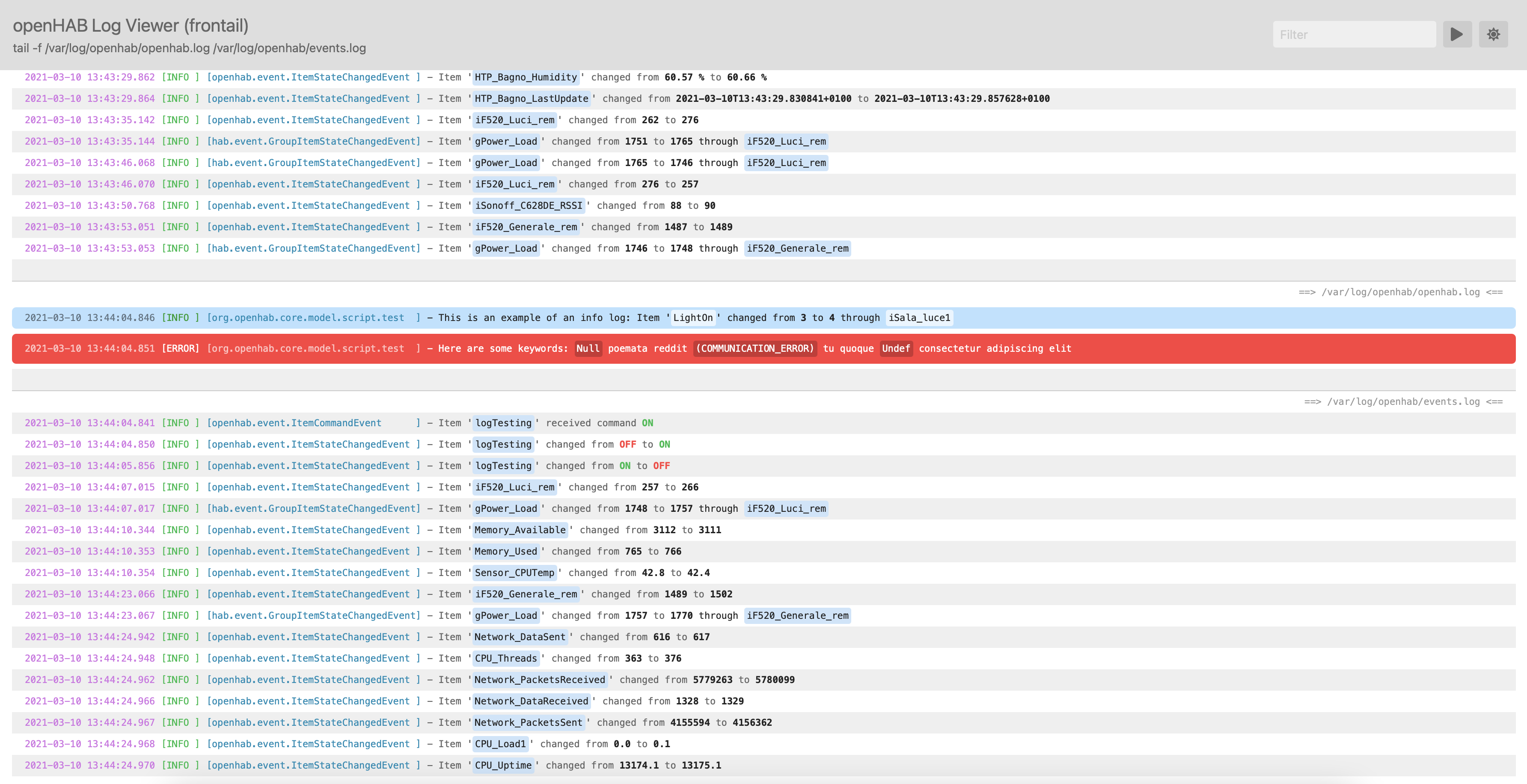

Ok, I tried to implement it on the fly, on the light theme. Here is the result:
I’m not sure, to be honest, if it makes things better. For sure there is a glitch to solve (empty lines should always be white, see for example the line under the red [ERROR] line). But it is a minor glitch.
In my usage, when I am interested in a specific line, or group of lines, i click them in order to highlight them.
On mobile, where the logs are displaied on multiple lines, I had already added a small division line between the log lines, to enhance readability, so in that case the alternating row colors are not so necessary.
BTW in order to achieve this result you just need to add this code to the css:
.log .line:nth-child(even) {
    background-color: #EFEFEF;
.log .line:nth-child(odd),
.log .line.logLine {
    background-color: #FFF;
This for the light theme. For the dark theme you need to change the colors accordingly (the respective HEX codes could be #32332C and #282922).
