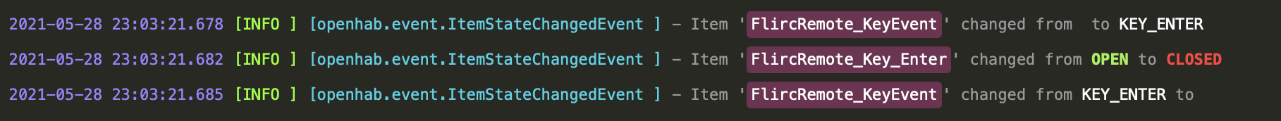

I did a quick test on my openHABian, it seems to render correctly:
This is the HTML it outputs:

Yes it does! Thanks a lot!
