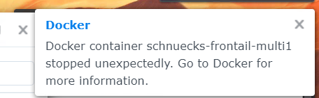

Bit late to the party but I’m in the process of moving my OH install to v3 and also from pi to Syno Docker. All going well and I’ve got a container from welteki working for logging via frontail.
I’ve just come across this thread as I was wondering if I could make the logs a bit more user / read friendly…and you guys have pretty much read my mind and done it for me…THANKS!
However, I’ve found the image schnuecks/frontail-multi:latest on docker, downloaded and launched it. Added the logs volume to the settings and run the container…
but it just runs for a second and then throws this error:
I’m relatively new to docker and have been trawling the thread and docker docs to work out what I’ve done wrong but I’m hoping one of the clever people on this thread can tell me where I’ve gone wrong / point me in the right direction.
TIA.
