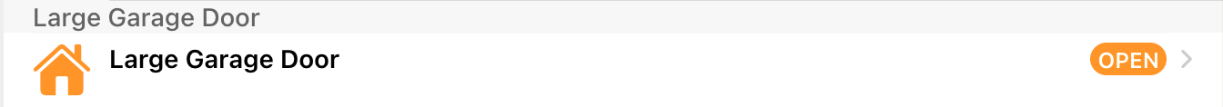

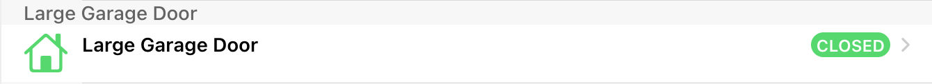

A garage door widget that shows the open/closed state of a garage door and allows one to trigger the garage door opener. Clicking on the widget will trigger the opener. The color, icon, and badge on the right indicates the current state of the door. The widget requires two Items, a Contact Item that indicates the open/closed status of the door and a Switch Item that, when it receives an ON command will trigger the garage door opener.
