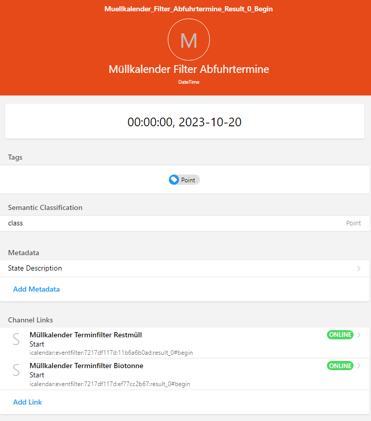

The first post says:
4.3 The used channel is "result_0#begin
Since I did not manage to create multiple items with this code snippet, I created 1 groupe item.
However, I think that this way was wrong, right?
In the end, the question remains for me:
What is the exact path: calendar thing → items → widget?

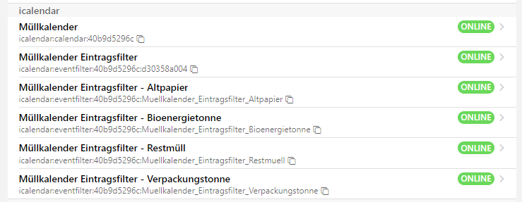

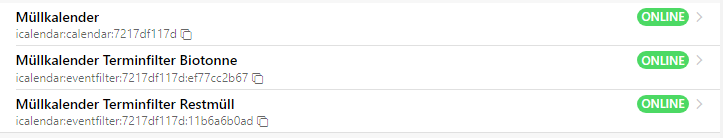

with the Garbage Collection widget you have to first install a “icalendar”-Thing as described in your first link. Some Bindings need mor things - and this is the case here. First of you have the “icalendar configuration” thing, which simply provides access to the CalDAV-calendar. Then theres (three of four) things for each of the garbage colour (“icalendar filter” things). Those things filter your garbage calendar for the different kind of garbages - you only have to filter for e.g. the text in the title.
So at the end you have four or five things, and only the filter things have the channels we need to use for the widget:
  1. Start (at least this one is needed!)
  2. End
  3. Title
you open one of those “channels” and add one item at least every “start” channel, so you end up with a minimum of 3 items (each color one item - if you’re not having “gelber Sack” also, which would be #4 then)
In your example you added both “Restmüll” and “Biotonne” Start-channel to one item, you have to have different items!
last of all, you then enter the item-names in the widget with the “datearray”-attribut and the widget does the rest, for example my configuration:

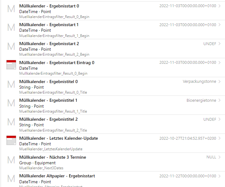

just wanted to share my progress with this. Instead of using the same datasource as shown above I always tracked my garbage collection via ical and google calendar.
The difference in my setup shows in the items itself as I don’t have items for each trash can, but items for the next few events in the calendar and they are therefore sorted right away.
MullkalenderEintragsfilter_Result_0_Begin ➔ Date of event start
MullkalenderEintragsfilter_Result_0_Title ➔ Trash information converted into readable names
MullkalenderEintragsfilter_Result_0_Color ➔ Trash information converted into matching color
Title and Color are two items connected to the same thing, being the calendar event title, but they are transformed via two separate .map files shown below.
