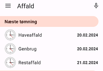

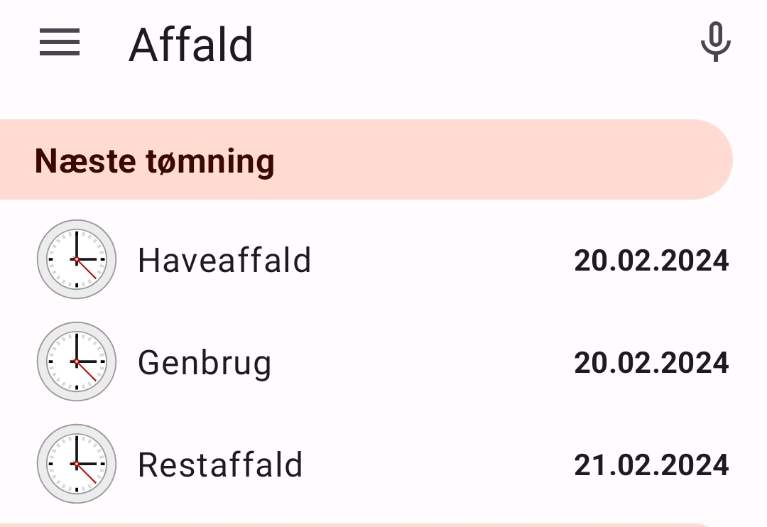

That’s it, really. Sitemap example:

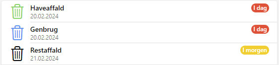

Or widget Garbage Collection:
component: widget:garbage_list_v1
datearray: '"Haveaffald","green","f7:trash","RenoWeb_NextPickup_GardenWaste"|"Genbrug","blue","f7:trash","RenoWeb_NextPickup_Recycling"|"Restaffald","black","f7:trash","RenoWeb_NextPickup_MixedWaste"'
tomorrow: I morgen
today: I dag
