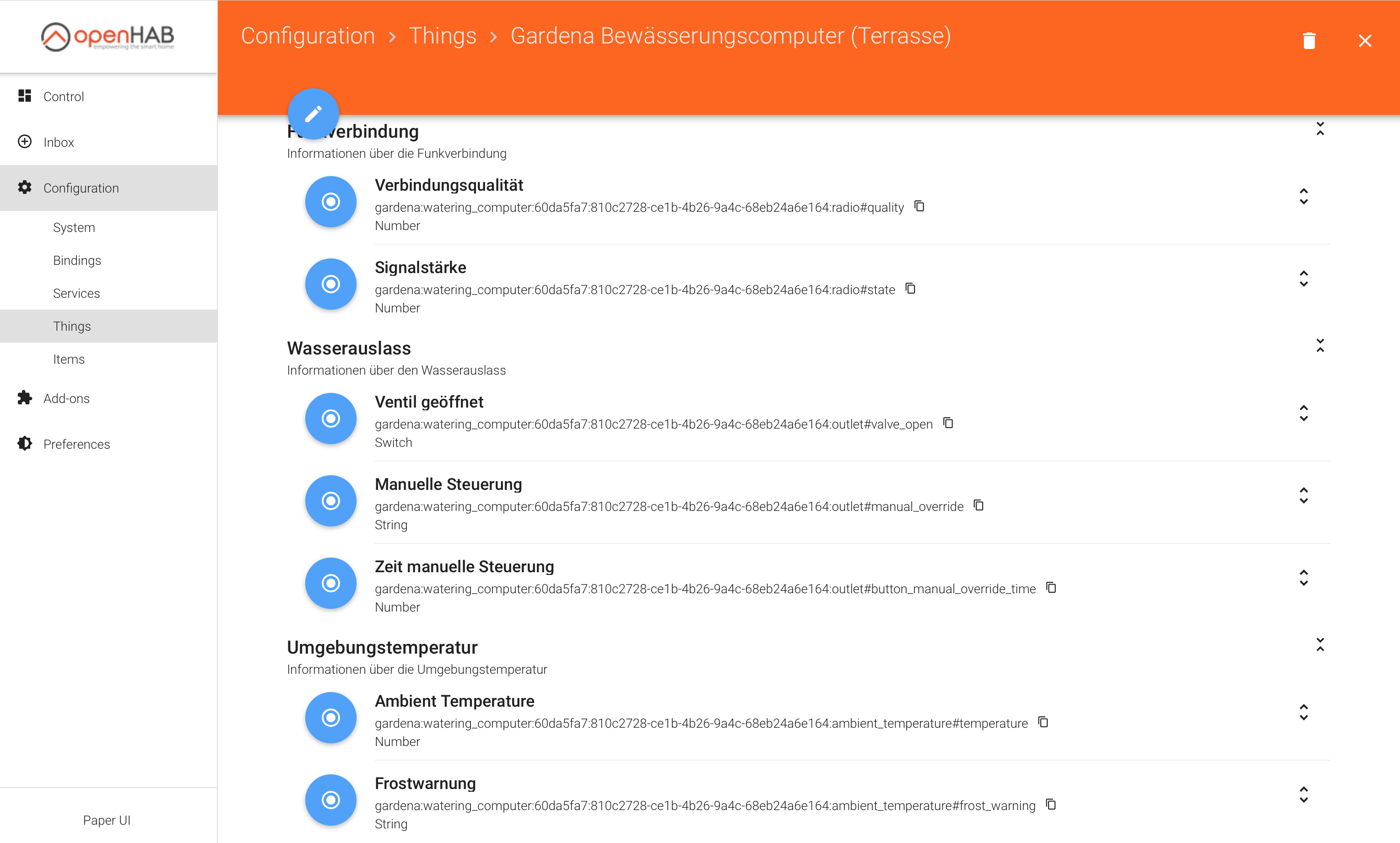

Not sure if the ä is the issue, b/c the log found the device, but try changing it and see what happens.

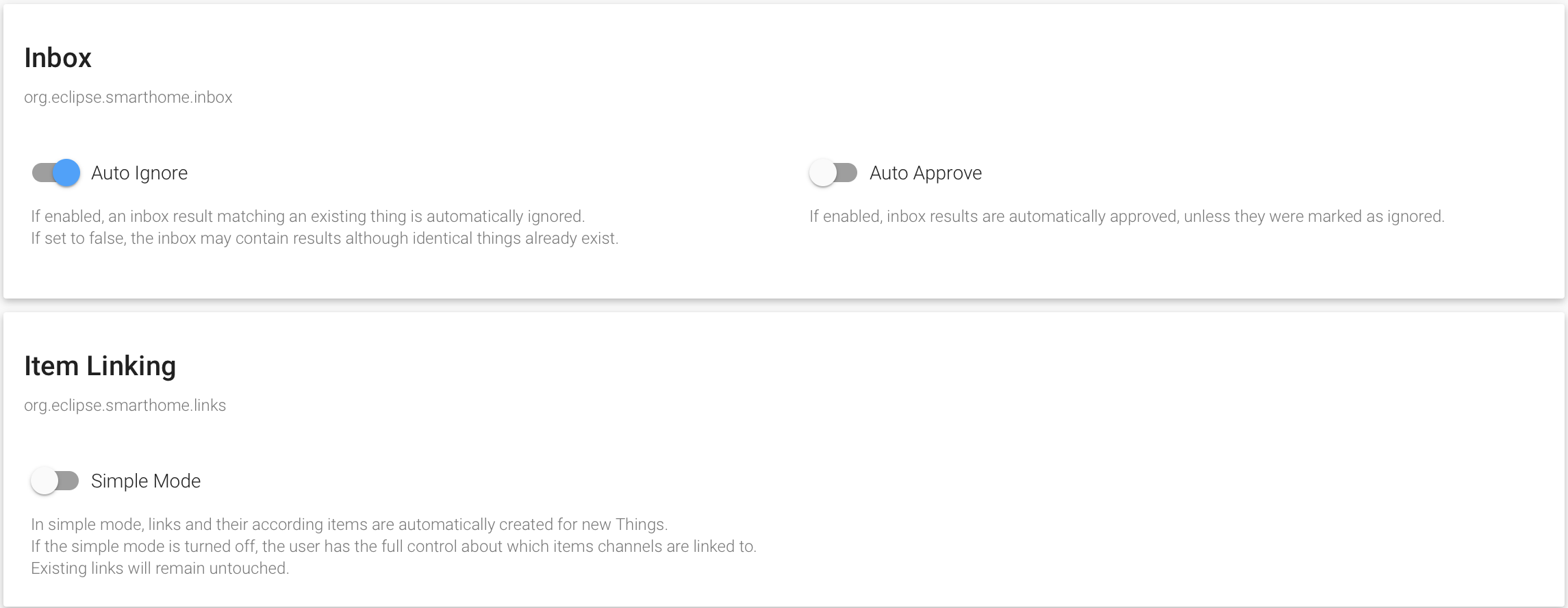

I would think the problem is “outlet” not being found in the device. If you have simple mode turned on and created the things manually you may have duplicates that are causing this.
To check for duplicates:
Look in /var/lib/openhab2/jsondb/org.eclipse.smarthome.core.thing.link.ItemChannelLink.json and make sure there isn’t a Link hanging around. Also, for items check: /var/lib/openhab2/jsondb/org.eclipse.smarthome.core.items.Item.json
Note, If you find a duplicate make sure to stop OH before making any changes to these files.
Don’t know what you mean with simple mode. I added the thing automatically in PaperUI: Inbox - + - Gardena Binding …
The thing gets discovered automatically
This file: /var/lib/openhab2/jsondb/org.eclipse.smarthome.core.thing.link.ItemChannelLink.json is empty, only contains {}
This file /var/lib/openhab2/jsondb/org.eclipse.smarthome.core.items.Item.json is also empty

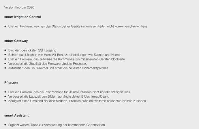

I create all my things and items on file level, not in PaperUI. Also for Gardena. Since I started this season ~1 week ago, I face the same problem as described above, only with watering_computer, and those 5 channels as mentioned by CHTHSCH: outlet#valve_open, outlet#manual_override, outlet#button_manual_override_time, ambient_temperature#temperature, ambient_temperature#frost_warning, while the rest are working. Watering Computer received a firmware update when I started it. Sensor and power outlet act well. Cleaning and rebooting openHAB doesn’t add any value. Used PaperUI to crosscheck channel detection, all expected show up. As Gardena/Husqvarna did quite some internal changes for the Feb release, I do expect some blocking changes in communication or naming of those parameters in their protocol: properties are promoted to the binding, but cannot be found/read from the query.
