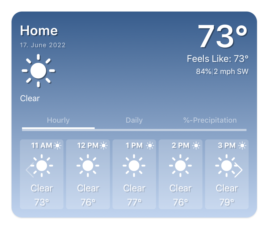

And it looks like this:
In addition to the weather card widget file that you’ll use to create a new widget in the OpenHAB UI, you will need to add an empty file called “dummy.js” in your config/html directory, but that’s a one-time thing.
The widget does some “magic” that gets around forcing you to create a million items by parsing the JSON data before the widget fills things in. That, plus some of the extra fields the enrichment process contributes made the resulting widget code a lot simpler. Just be careful not to mess with the “onload” line in the widget. I’ve got some additional things I’d like to do (I want to add an option to use WeatherFlow’s weather icons, for example), so I will try to follow up when I have more to report.
