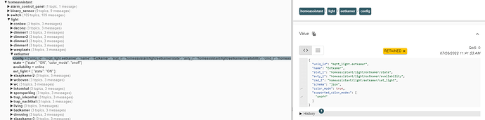

Hey Guys, need some beginner help, i have setup a generic MQTT thing, like yaml below
UID: mqtt:topic:e94f1500bd:dad57a579d
label: Eetkamer
thingTypeUID: mqtt:topic
configuration: {}
bridgeUID: mqtt:broker:e94f1500bd
channels:
  - id: eetkamer
    channelTypeUID: mqtt:switch
    label: Eetkamer
    description: ""
    configuration:
      commandTopic: homeassistant/light/eetkamer/set_light
      stateTopic: homeassistant/light/eetkamer/state
      off: '{ "state": "OFF" }'
      on: '{ "state": "ON" }'
Working great, i can turn on/off the light… but the i dont see the state changing when i change it externally, i think i need a json value for the state, the same like i do to send a payload to turn it on/off
how can i transform that ?
thnx

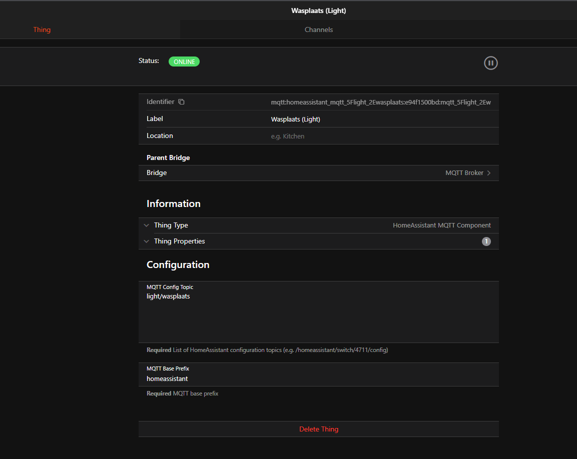

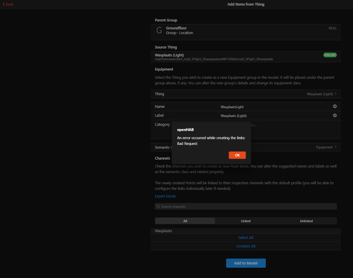

For some reason the channels are corrupted when they are auto discovered… So I need to make them all manual now… Are you using HA too?
No, never used HA (took a glance on it in the early state…)
Ah ok, np
But maybe you have a look what’s wrong with this thing that was auto discovered?
Read from this post:
No, sorry, no idea, I never rely on auto discovery…
Ok, np :slight_smile:
Then I need to create them one by one, a lof of work :frowning:
