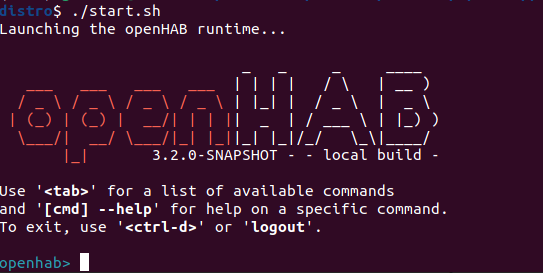

I now have the openhab-test-distro directory that I can launch directly by running the “./start.sh” script inside the directory as you can see in the image put here:
My question now is how can I get the interface of openhab (the dashboard) with this openhab-test-distro to debug it too?

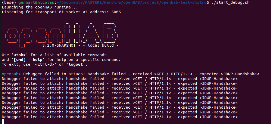

Hello, thank you for your answers,
No, it doesn’t work.
I have these listening post from my java process:

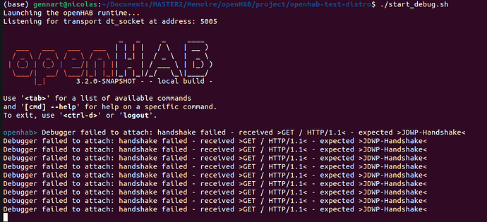

And on the terminal it shows that when I run start_debug.sh.
I tried with localhost:5005 but it does not work.
Do you know what the problem is?
Thank you,
Nicolas Gennart.
OK, some things to clarify, because I think there is some misunderstanding:
  • you can start openHAB in two modes
    • “normal” mode using the script start.sh
    • “debug” mode using the script start_debug.sh
  • openHAB will in both modes open port 8080 so you can use your browser to connect to (e. g. http://localhost:8080
  • you can see in the first screenshot that this happened (the 5th line in the output of netstat)
  • openHAB will only in debug mode open port 5005 additionally so you can use your debugger (IntelliJ) to connect to localhost on port 5005 (this is the 9th step in this tutorial)
  • I can see from the message in the second screenshot that you used your browser to connect to the debug port (5005)… use port 8080 instead as I mentioned above
Yes, I understood, I tried with port 5005 because my port 8080 is already used by a tomcat server.
So I try to remove my tomcat server.
You can also set the environment variable OPENHAB_HTTP_PORT to something other than 8080 to avoid the port conflict.
