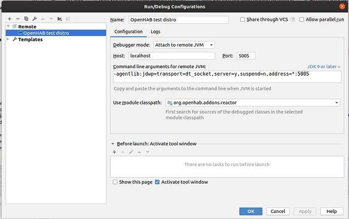

  9. create a Remote Debug runtime configuration in IntelliJ:
    • Open menu Run | Edit configurations
    • click the + sign to add a “Remote” configuration
    • adapt the module setting to the root (org.openhab.addons.reactor)
    • click OK
    • start the debug configuration
    • the IntelliJ console should log: Connected to the target VM, address: ‘localhost:5005’, transport: ‘socket’
      You can now add breakpoints to your project now and your test distro should stop there…

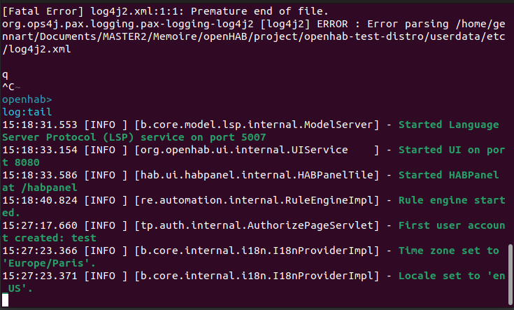

And how can I see that my jar addon is running in the openhab-distro?
here you can see my log:
Since your are already using the console you can list the bundles. Apart from that, use logging in your addon. Refer to the developer documentation to read up on that kind of stuff, e. g. Coding Guidelines | openHAB
