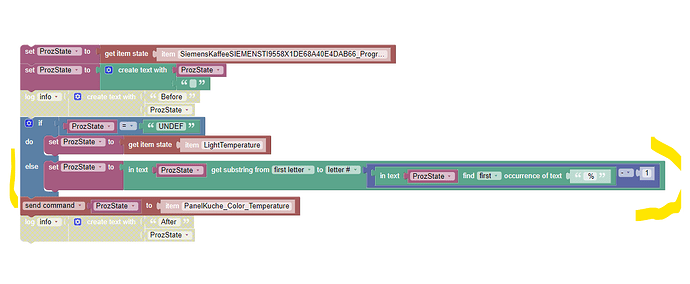

Thanks for that information. splitting strings is not an issue. I did this by removing the unit " %". (see below)
