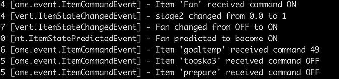

How do you know the index is stuck? Log out what you postUpdate and sendCommand in the one rule and log out what is it in the rule that triggers based on the updates. Also log out what’s in the ArrayList. Maybe it’s not what you assume. When code doesn’t work you cannot assume anything. You must verify everything.

Hello again. I try to refactor my rule and get rid of all sleeps … here is my new rule:

one time it updates:
as you see it only goaltemp.
