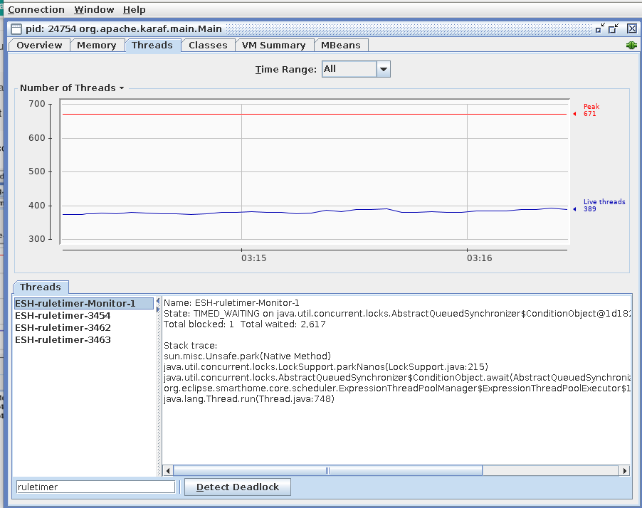

You can use jconsole to view the threads, in real-time…
I find this easier to get some quick results…
