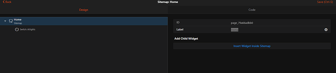

I’ve created a sitemap but its empty and I don’t know what do with it from here. When I click on the sitemap on the page settings, it asks to add widgets to it but it doesn’t allow me to design a page like the basicUI does. Can I add pages that I’ve already designed to that sitemap if so how?

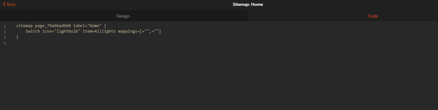

Please post your created sitemap.
Actually, MainUI is not available on iOS App, but should be back soon. This is mentioned in many post here…
Here is the code of the site map I’ve created.
