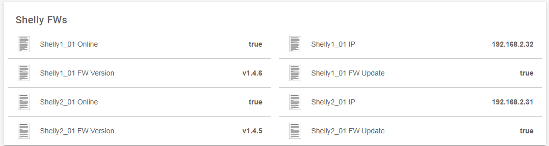

sitemap extract:
Frame label="Shelly FWs"
                Text item=Shelly1_01_Online
                Text item=Shelly1_01_IP
                Text item=Shelly1_01_FWVer
                Text item=Shelly1_01_NewFW
                Text item=Shelly2_01_Online
                Text item=Shelly2_01_IP
                Text item=Shelly2_01_FWVer
                Text item=Shelly2_01_NewFW
Result:

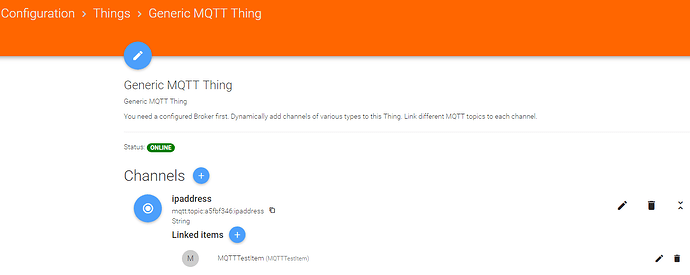

I don’t use .things files but the Thing would look something like in PaperUI:
The Request Announce Channel is just a switch with a mapping configured so whenever it receives ON or OFF it publishes “announce” to the command topic.
MQTT Command Topic: shellies/shelly1-25A289/command
Custom On/Open value: announce
Custom Off/Closed value: announce

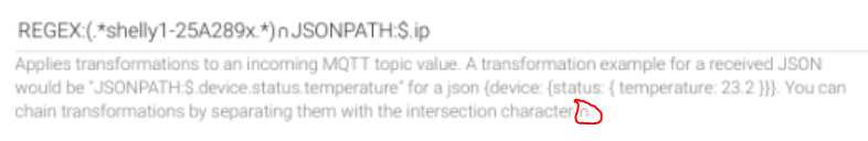

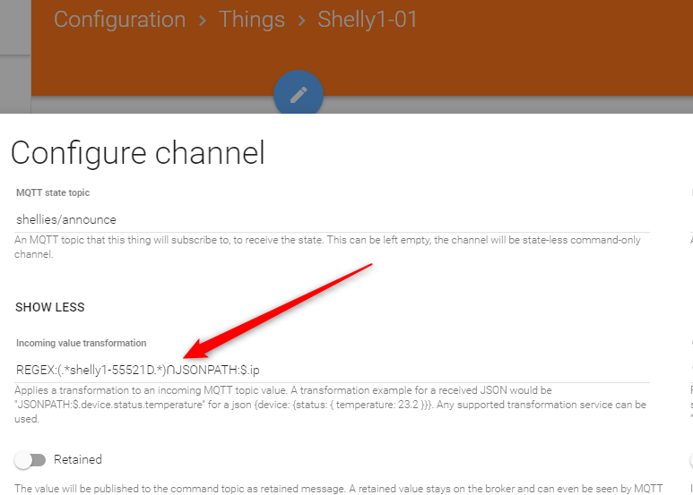

Now let’s look at the IP Channel.
MQTT state topic: shellies/announce
Incoming value transformations: REGEX:(.*shelly1-25A289.*)∩JSONPATH:$.ip
The transformation will match the full message but only if it has the “shelly name”, in this case shelly1-25A289. It appears that there is no error in the logs when the REGEX doesn’t match anything. If it does match then it passes the full JSON to the JSONPATH where the IP field is extracted.
I only have one Shelly set up right now so can’t fully test this, but when I “break” the REGEX on this Thing nothing happens (which is what we want) and when I fix it so it’s correct I get the IP address.
So I recommend implementing all of your second Rule in your Things and link the Items to the Channels.This way the “shelly name” for the device is wholly contained within the Thing freeing you to not know nor care what Shelly decided to name this device in your Rules or your sitemap nor the need to provide some external mapping between that and your chosen Item names.
awesome reply!!! I will test it soon
@rlkoshak

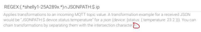

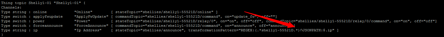

unfortunately I have a problem with the thing configuration mentioned above. The REGEX part works, but JSONPATH is ignored. What kind of special character did you use after the closing bracket, just in front of the J for JSONPATH?
Did you install the JSONPATH transform?
The character is what the binding developer chose to separate transforms. It’s the mathematical set intersection operator I think. You can just copy the character from the text under the filed in PaperUI.
EDIT: Could it be that I require a later snapshot of the binding??? I don’t even see this sentence about the special character in my paperui

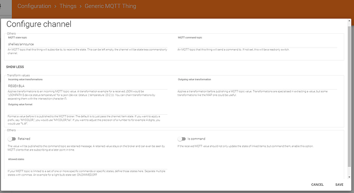

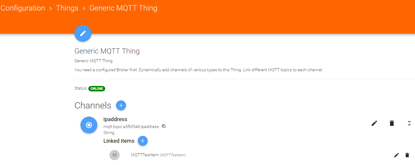

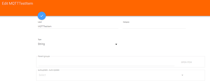

thanks, this explains a lot, but still doesn’t solve my issue. when I did copy/paste of the character via ssh session, it got converted to a bullet point. so I changed the character encoding in putty to UTF 8 and now it looks good.
Automatic addition in PaperUI:
But it still doesn’t work (just REGEX)
Shelly1_01_IP changed from UNDEF to {“id”:“shelly1-55521D”,“mac”:“B6E62D55521D”,“ip”:“192.168.2.32”,“new_fw”:false, “fw_ver”:“20190214-074430/1.4.7-revertwifi@0f3372b3”}

log
2019-03-27 21:26:19.575 [vent.ItemStateChangedEvent] - Shellies_AnnounceData_String changed from {id:shelly1-55521D,mac:B6E62D55521D,ip:192.168.2.132,new_fw:true, fw_ver:20190214-074430/1.4.7-revertwifi@0f3372b3} to {id:shelly1-55521D,mac:B6E62D55521D,ip:justfake,new_fw:true, fw_ver:20190214-074430/1.4.7-revertwifi@0f3372b3}
2019-03-27 21:26:19.607 [vent.ItemStateChangedEvent] - Shelly1_01_IP changed from 192.168.2.132 to justfake
2019-03-27 21:26:19.613 [vent.ItemStateChangedEvent] - Shelly2_01_IP changed from 192.168.2.132 to justfake
Thanks in advance

that’s indeed interesting. maybe it’s a bug? I re-created a Generic MQTT Thing via PaperUI, create an TestItem in PaperUI and then linked the item to the channel via PaperUI, same issue. If I enter something like “BLA” into the transformation field I do see an error in the log. But as soon as I turn this into REGEX:BLA it will be accepted and ignored.
Just in case something shows up as obvious, I wrote a tutorial on how I did this: MQTT 2.5 M1+ How to implement the equivalent to MQTT1 REGEX filters. That contains my current configuration.
REGEX:bla should accept all incoming mqtt values that are exactly “bla”.
If you use regex first, you must make sure that a valid JSON is produced out of that transformation otherwise the jsonpath cannot work successfully.
thanks for trying to help. it’s driving me crazy. I’ve read your tutorial, but it seems all good to me. Here some screenshots:
four
and the log shows:
2019-03-29 10:03:11.299 [vent.ItemStateChangedEvent] - MQTTTestItem changed from UNDEF to this just doesn't make sense
Finally, if I change the transformation value from “REGEX:BLA” to just “BLA” I do see an expected error in the logs:
2019-03-29 10:33:24.572 [WARN ] [internal.handler.GenericThingHandler] - Channel configuration error
java.lang.IllegalArgumentException: The transformation pattern must consist of the type and the pattern separated by a colon
But then again, as soon as I enter “BLA:BLA” the thing configuration will be accepted and the thing goes online. Again the transformation will just be ignored and the item gets assigned the full announce string.
So I’d say, either my installation is somehow corrupted, or it’s a bug.
Any idea how to generate debug logs for the transformation process?
Ah ok. So you are saying that there should be an error log if a transformation cannot be found instead of just passing the value on.
Please create an issue on GitHub to track this.
But wouldn’t that break this use case?
The use case (i.e. using REGEX to filter out messages published to a single topic so only certain ones get passed to the JSONPATH) depends on REGEX failing silently and passing the full message on if there is no match.
If the transform is malformed it does makes sense that there is an error.
