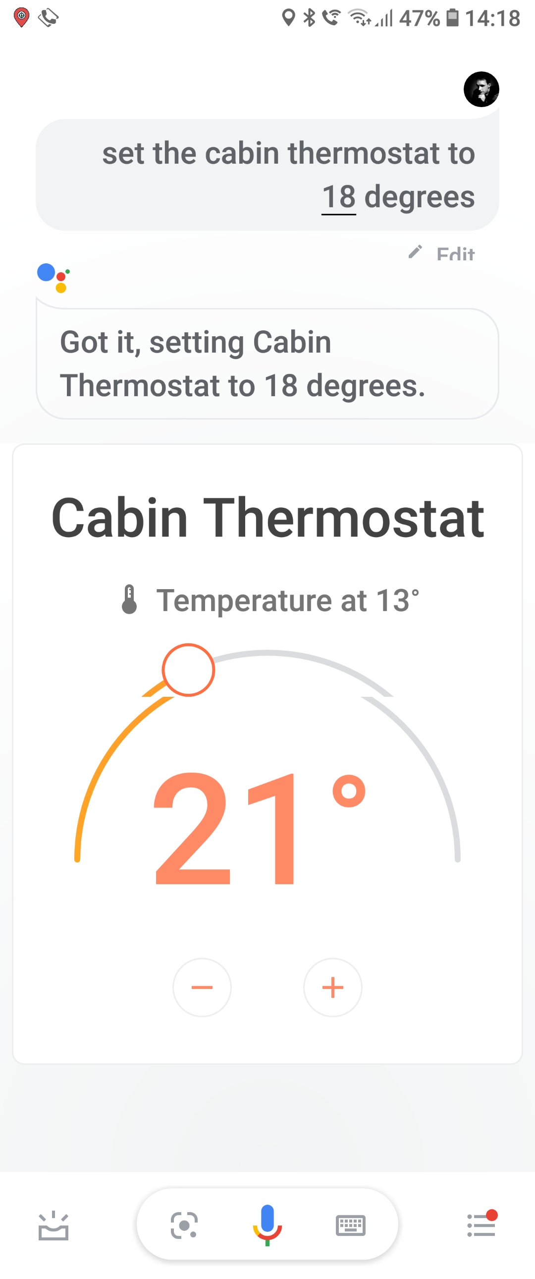

What does the thermostat widget show in Google Home / Google Assistant?
Are the values correct there?
For example, the above is correct.
Where current temperature is 13°c

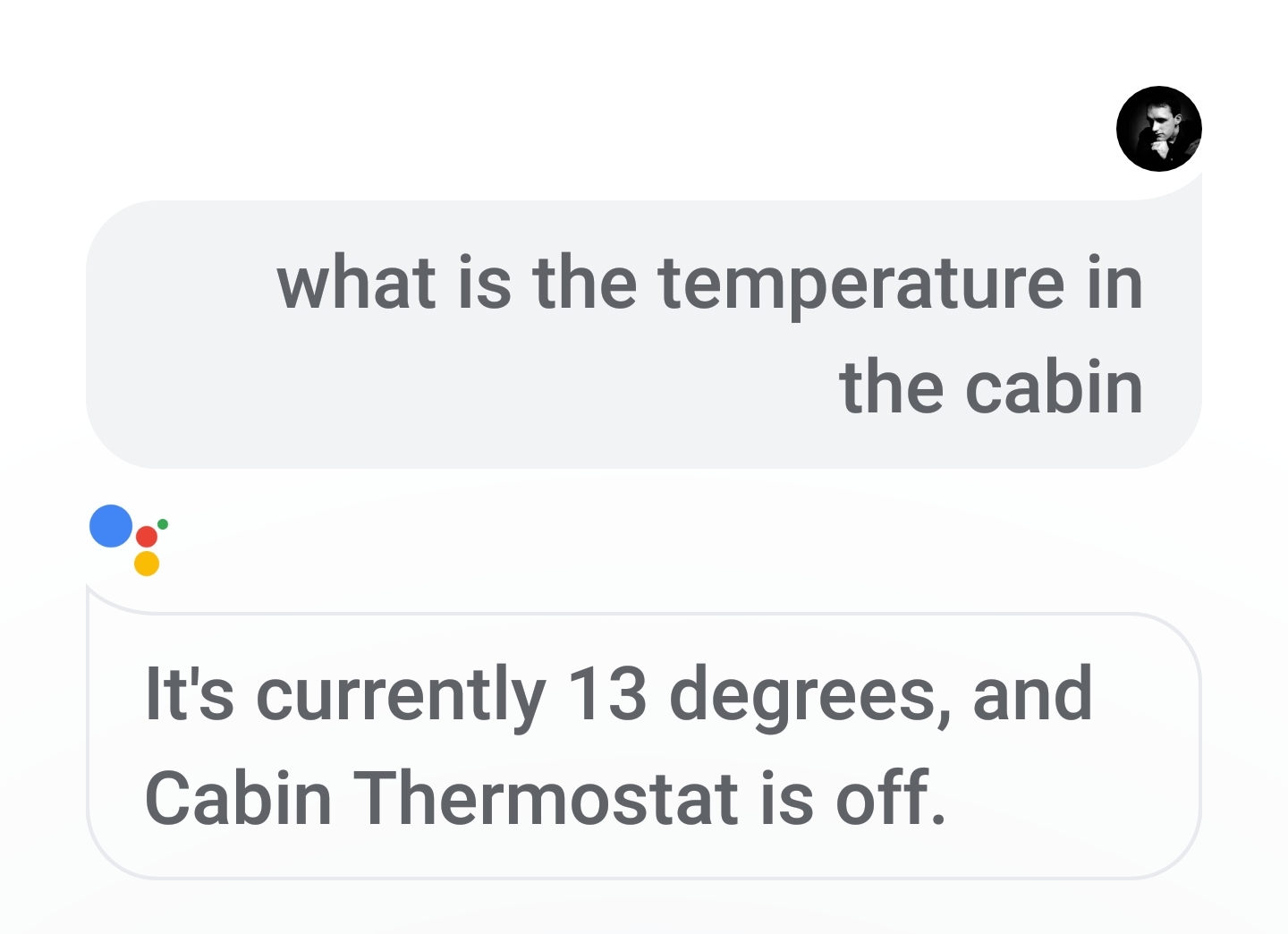

4
Curious
I’m getting these results
But I can’t work out how to ask what the current setpoint is
