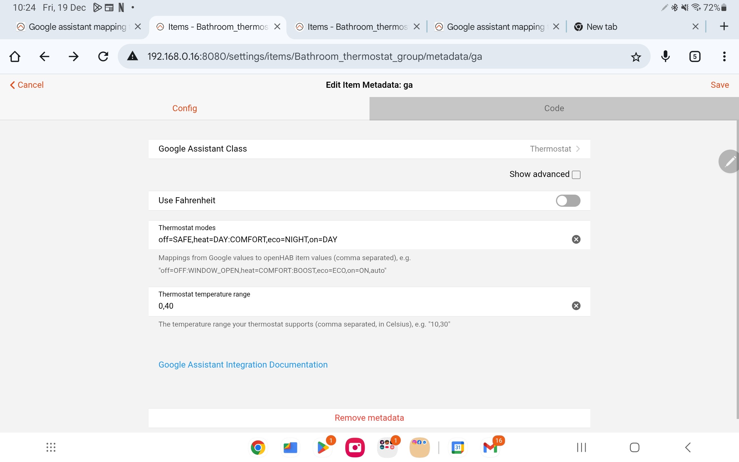

I have an Openhab 5.0.2 setup connected to a Velbus installation with a vmbel1 module which I want to use as a thermostat. I want to make it configureable in Google Home too. I followed the instructions here (Google Assistant | openHAB) which worked partially. I can now see my thermostat, but I can’t change anything. The set temperature is immutable in Google Home and the modes aren’t being mapping correctly.
As described in the docs, i created a group with 3 members:
  • Bathroom_Thermostat_currentTemp
  • Bathroom_thermostat_mode
  • Bathroom_currentTemp_setpoint
The mode item has the following GA metadata config:
value: thermostatMode
supportedModes:
- Day
- Night
- Comfort
- Safe
The group GA metadata looks like this:
value: Thermostat
  thermostatTemperatureRange: 0,40
  modes: off=SAFE,heat=DAY,eco=NIGHT,on=DAY
  roomHint: Bathroom
Whatever mode I choose in Openhab (Safe, Day, Night or Day) doesn’t show up in Google and just shows as “On”.
Whatever mode I choose in Google defaults to the “Safe” mode in Openhab. It looks like the Google values are being sent to my mode item which are being rejected since they weren’t mapped. The logs show this:
INFO openhab.event.ItemCommandEvent Item 'Bathroom_thermostat_mode' received command heat
INFO openhab.event.ItemStatePredictedEvent Item 'Bathroom_thermostat_mode' predicted to become heat
INFO openhab.event.ItemStateChangedEvent Item 'Bathroom_thermostat_mode' changed from SAFE to heat
INFO openhab.event.ItemStateChangedEvent Item 'Bathroom_thermostat_mode' changed from heat to SAFE
The docs mention For the translation of Google modes to openHAB always the first option after the equal sign is used so I would assume that the Google values would have been mapped as described in the group GA metadata
Am I missing something here ?

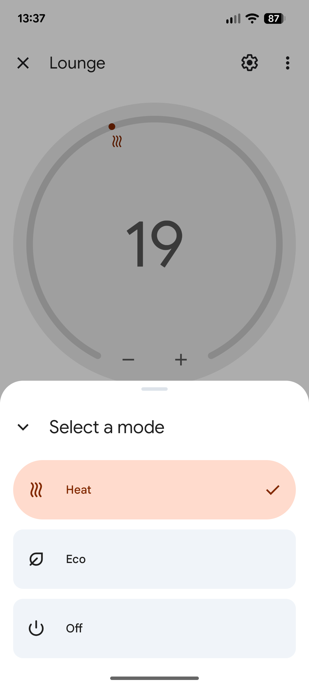

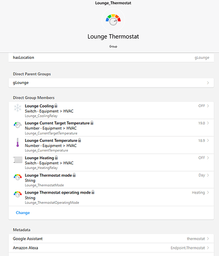

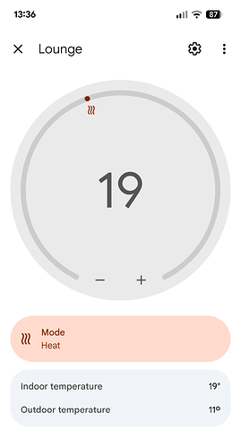

FYI
This is my working Text file Items configuration for a Velbus thermostat, with Alexa and Google MetaData.
// Thermostat Items
// Semantic Item convention
//	Type	MachineName						"Human readable name"			<icon>			(groups)	["Semantic Type"]	{channel}
// New Google Assistant and Alexa Metadata tagging
	Group 	Lounge_Thermostat				"Lounge Thermostat" 				<heating> 		(gLounge)			 ["HVAC"]													{ga="thermostat" [thermostatModes="off=SAFE,heat=DAY:COMFORT,eco=NIGHT,on=DAY", roomHint=" Lounge"], alexa="Endpoint.Thermostat" }
	Number 	Lounge_CurrentTemperature 		"Lounge Current Temperature" 		<temperature>	(Lounge_Thermostat, WholeHouse_CurrentTemperature)			["HVAC"]	{channel="velbus:vmbgpod:VelbusNetworkBridge:2C:input#CH33"								,	ga="thermostatTemperatureAmbient" 	,	alexa="TemperatureSensor.temperature" }
	Number 	Lounge_CurrentTargetTemperature	"Lounge Current Target Temperature"	<heating>		(Lounge_Thermostat, WholeHouse_CurrentTargetTemperature)	["HVAC"]	{channel="velbus:vmbgpod:VelbusNetworkBridge:2C:thermostat#currentTemperatureSetpoint"	, 	ga="thermostatTemperatureSetpoint"	,	alexa="ThermostatController.targetSetpoint"}
	String 	Lounge_ThermostatMode 			"Lounge Thermostat mode"	  	 	<heating>		(Lounge_Thermostat, WholeHouse_ThermostatMode			)				{channel="velbus:vmbgpod:VelbusNetworkBridge:2C:thermostat#mode"						,	ga="thermostatMode"  				,	alexa="ModeController.mode" [friendlyNames="@Setting.Preset", supportedModes="SAFE=Safe,NIGHT=Night,DAY=Day,COMFORT=Comfort"]}
	String 	Lounge_ThermostatOperatingMode 	"Lounge Thermostat operating mode"	<heating>		(Lounge_Thermostat, WholeHouse_ThermostatOperatingMode	)				{channel="velbus:vmbgpod:VelbusNetworkBridge:2C:thermostat#operatingMode"														,	alexa="ThermostatController.thermostatMode" [COOL="COOLING",HEAT="HEATING"]	}
	Number	Lounge_HeatingComfortTarget 	"Lounge Heating Comfort Target Temperature"		<temperature>	(WholeHouse_HeatingComfortTarget 	)						{channel="velbus:vmbgpod:VelbusNetworkBridge:2C:thermostat#heatingModeComfortTemperatureSetpoint"		}
	Number	Lounge_HeatingDayTarget 		"Lounge Heating Day Target Temperature"	  		<temperature>	(WholeHouse_HeatingDayTarget 		)						{channel="velbus:vmbgpod:VelbusNetworkBridge:2C:thermostat#heatingModeDayTemperatureSetpoint"			}
	Number	Lounge_HeatingNightTarget 		"Lounge Heating Night Target Temperature"	 	<temperature>	(WholeHouse_HeatingNightTarget 		)						{channel="velbus:vmbgpod:VelbusNetworkBridge:2C:thermostat#heatingModeNightTemperatureSetpoint"			}
	Number	Lounge_HeatingAntifrostTarget	"Lounge Heating Antifrost Target Temperature"	<temperature>	(WholeHouse_HeatingAntifrostTarget	)						{channel="velbus:vmbgpod:VelbusNetworkBridge:2C:thermostat#heatingModeAntiFrostTemperatureSetpoint"		}
	Number	Lounge_CoolingComfortTarget 	"Lounge Cooling Comfort Target Temperature"		<temperature>	(WholeHouse_CoolingComfortTarget)							{channel="velbus:vmbgpod:VelbusNetworkBridge:2C:thermostat#coolingModeComfortTemperatureSetpoint"		}
	Number	Lounge_CoolingDayTarget			"Lounge Cooling Day Target Temperature"			<temperature>	(WholeHouse_CoolingDayTarget	)							{channel="velbus:vmbgpod:VelbusNetworkBridge:2C:thermostat#coolingModeDayTemperatureSetpoint"			}
	Number	Lounge_CoolingNightTarget 		"Lounge Cooling Night Target Temperature"		<temperature>	(WholeHouse_CoolingNightTarget 	)							{channel="velbus:vmbgpod:VelbusNetworkBridge:2C:thermostat#coolingModeNightTemperatureSetpoint"			}
	Number	Lounge_CoolingSafeTarget		"Lounge Cooling Safe Target Temperature"		<temperature>	(WholeHouse_CoolingSafeTarget	)							{channel="velbus:vmbgpod:VelbusNetworkBridge:2C:thermostat#coolingModeSafeTemperatureSetpoint"			}
// heating & cooling relays if you want to include them in this Items file
	Switch	Lounge_HeatingRelay	"Lounge Heating"	<radiator>	(WholeHouse_HeatingRelay,WholeHouse_HeatingRelay_Count,Lounge_Thermostat	)	["HVAC"] 	{channel="velbus:vmb4ryno:VelbusNetworkBridge:74:CH1"}
	Switch	Lounge_CoolingRelay	"Lounge Cooling"	<climate>	(WholeHouse_CoolingRelay,WholeHouse_CoolingRelay_Count,Lounge_Thermostat	) 	["HVAC"]	{channel="velbus:vmb1ryno:VelbusNetworkBridge:71:CH3"}
I don’t do Item to Thing configuration in the MainUI as I just can’t wrap my head around it (and Bulk editing to get client systems up and running is SO much easier with text files.)

the Code for the Group Item for the Lounge Thermostat looks like this
label: Lounge Thermostat
type: Group
category: heating
groupNames:
  - gLounge
tags:
  - HVAC
groupType: None
function: None
Which looks like this is Google Home
The Mode mapping is important and it works
Heat = Day (or Comfort)
Eco = Night
Off = Safe
But where that Text file mapping is shown in MainUI is a mystery to me.
I’m not sure if this helps you at all, but the MainUI shows this when I open the Lounge Thermostat group
Hey,
Thanks for your reply, i’ve been trying to mimic this as much as possible but without any result.
The mapping of those heating modes to Google Home can be found in the metadata menu of your gLounge group > Google Assistant > Thermostat Modes
There I filled in this value, similar to yours: off=SAFE,heat=DAY:COMFORT,eco=NIGHT,on=DAY
But the behaviour stays the same. I can’t change my target temperature, same for the heating modes.
Can I suggest you do it with a text file, just so you can be 100% clear that what you have configured is identical to what I have working here? (and on other client site)
Once you have it set in a Text file and working, you can look at migrating that to the Mainui method, unfortunately, I can’t help with that as it’s just not what I do to get the basics working.
(imagine all those screen clicks when there are hundreds of items to add, where a copy, paste and sectional text editing can be done in a fraction of the time.
I'm also not 100% sure how everything relates to each other in the MainUI, when it seems so very clear in Text form)
What I am trying to achieve is to identify if the issue is :-
  • With the way the Velbus thermostat is set up within openHAB?
  • Are the MetaTags correct for Google?
  • Can you adjust the target temperatures correctly within openHAB

Just as a reference
I have tried a series of commands with Google to prove out my own configuration.
The utterances aren’t intuitive, but they seem to work
“Ok Google, What is the temperature in the Lounge”
Google responds with the correct temperature and says the target temperature is 14Âş and the mode is "ECO"
“Ok Google, Set the Lounge Target temperature to 20º”
Google responds "Lounge set to 20Âş"
“Ok Google, Set the lounge thermostat to HEAT mode”
Google Responds, "Lounge set to HEAT mode"
“Ok Google, Switch off Lounge thermostat”
Google responds, "Lounge Thermostat turned OFF"
“Ok Google, Set the Lounge thermostat to 19º”
Google responds, "Lounge set to 19Âş" (But leaves the Velbus thermostat in AntiFreeze mode, just with a new temporary target temperature)

Thanks! That breakdown via the Google Commands actually helped a lot.
In my openHab I can indeed change all values without any issues. But looking at the logs it was really that mapping part that went wrong.
I think I found a bug in the openHab UI where it puts the mapping string under a “modes” key in the meta data > Google Assistant config of the thermostat group. This has to be thermostatMode since v4.0.0 according to the docs.
Changing it in the code part to
thermostatModes: heat=DAY:COMFORT,eco=NIGHT,off=SAFE
… works like a charm :slight_smile: it doesn’t exactly does what your setup does. When asking for the current temperature, my assistant only replies with the current thermostat mode. But in the app it works ok now

As for the current temp, have you got that Item included in the Group, with the correct Google tag? ga="thermostatTemperatureAmbient" (does the app widget show the current temperature?)
