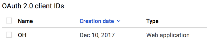

Two oauth IDs were created. Which one of the two are you using:
Thanks,
Tadey
I have created new of type ā€œWeb applicationā€:
