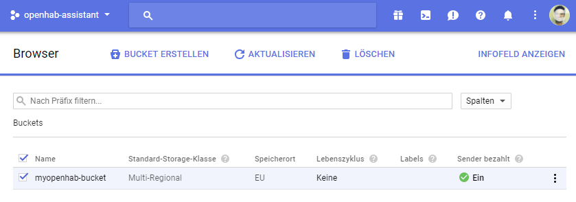

I have created the bucket in the project and enabled the payment-checkbox.
This command still throws an error:
gcloud beta functions deploy openhabGoogleAssistant --stage-bucket staging.[WHAT TO WRITE HERE?].appspot.com --trigger-http
Do I have to edit one of these before deploying?
EDIT:
it worked with
D:\Projekte\openhab-google-assistant\functions>gcloud beta functions deploy openhabGoogleAssistant --stage-bucket myopenhab-bucket --trigger-http
Deploying function (may take a while - up to 2 minutes)…done.

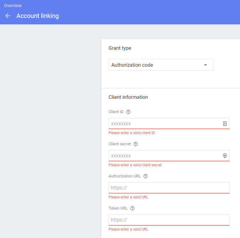

Now I’m at this point, too.
From where do I have to take these values?
Are Id and secret my logincredentials from my myopenhab-installation?
And wich URLs should I use?
I don’t understand the concept:
  1. Tried it with user and url of my myopenhab-instance - without success

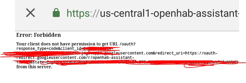

  2. Tried it with https://us-central1-openhab-assistant-123123.cloudfunctions.net/oauth and Google-Credentials. Then came an error
