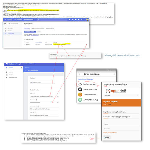

Please help me what to enter here:
Tried the whole weekend without success.
Post #260 will help you
the ID/secret can be generated in the google cloud console “API und Dienste” → Zugangsdaten
There you have to create web application oauth credential - you can leave the URL stuff blank there
You’ll also have to insert the token and id/secret to the openhab cloud mongo db … It’s somewhere in this thread
@sebmarchand you are the one
Big kudos to you … that fixed it
Hmm, whats wrong now?
One last step is missing :frowning:
