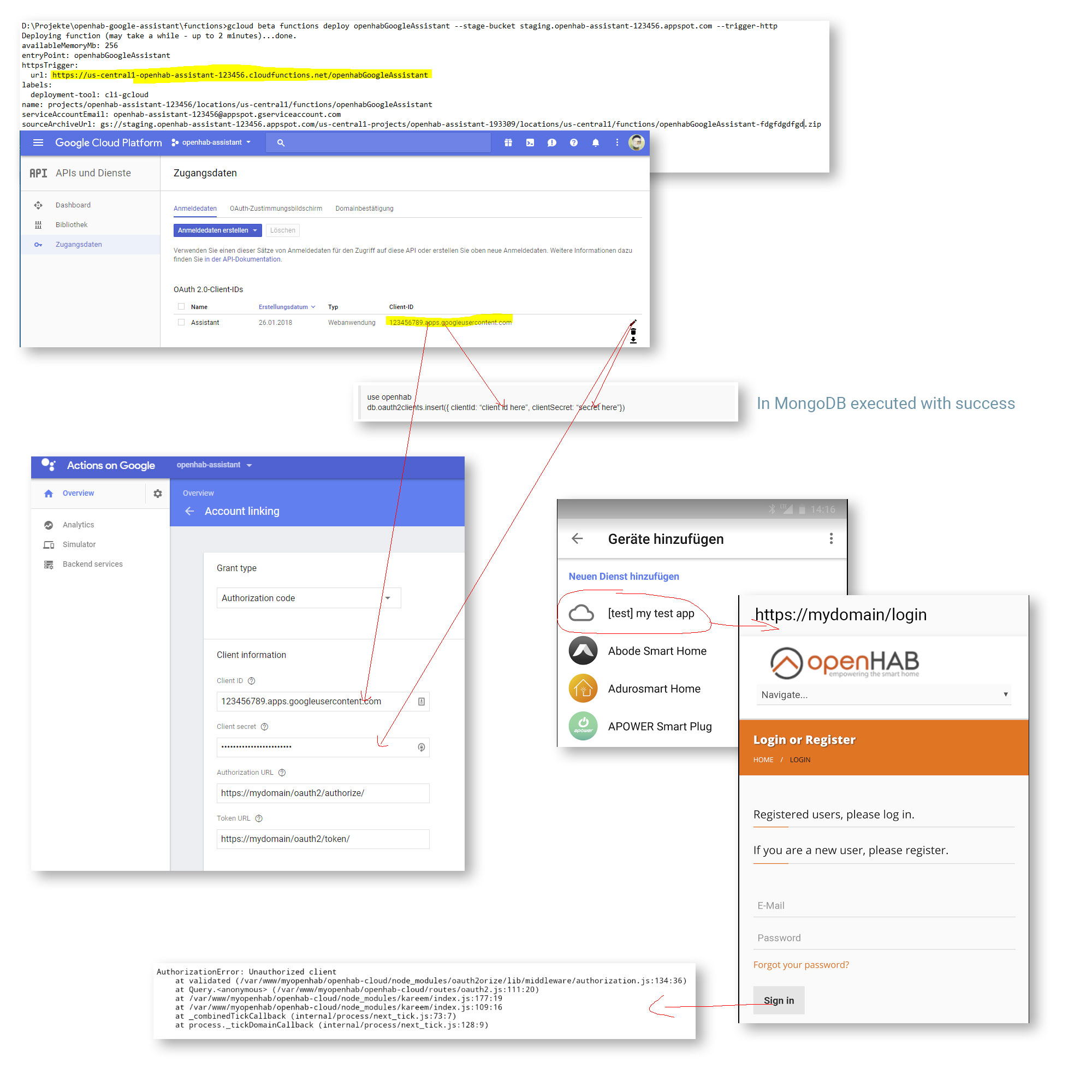

I have an issue with Assistance account linking. I have provided endpoint as https://< cloud host >/oauth/authorize and error reported as Cannnot GET /oauth/authorize. Dont know how to enable oauth service on openhab cloud instance. Please suggest if any step missing
What does “Cannnot GET /oauth/authorize” mean?
What do your openhab-cloud logs say? What about the openhabassistant function logs?
The more info the more helpful we can be.
What code changes and how do you deploy openhab-google-assistant locally?

in the attaed image there’s my error message after oauth
Is there any guide in the net in order to set it up completely from scratch? Would be extremely appriciated!
Configured openhab-google-assistant with help of link GitHub - openhab/openhab-google-assistant: openHAB Google Assistant: Actions on Google for openHAB. Also, openhab AWS cloud instance configured as per link Githhub README.md
Checked openhab cloud logs and there is nothing for “Cannnot GET /oauth/authorize”. Logs as below

115.110.104.225 - - [30/Jan/2018:07:54:40 +0000] "GET /oauth/authorize?response_type=code&client_id= &redirect_uri=ht$
115.110.104.225 - - [30/Jan/2018:07:54:41 +0000] “GET /favicon.ico HTTP/1.1” 200 2180 "https://< host >/oauth/authorize?response_type=code&client_id=
115.110.104.225 - - [30/Jan/2018:08:27:37 +0000] "GET /oauth/authorize?response_type=code&client_id=< Id >&redirect_uri=ht$
Please suggest anything missing or need to check
This oauth issue has been resolved. Its my bad - in url added /oauth/ instead of /oauth2/

I think you might be missing the scope in mongodb, see @MARZIMA previous post on this
The fact that you are getting your OH-Cloud instance on the Home App means you are almost there…

  • The account linking on Google Actions should look like this:
Authorization URL : https:// youropenhab-cloud/oauth2/authorize
Token URL : https:// youropenhab-cloud/oauth2/token
  • The action.json that you upload to Google should look like this, after you have enabled the openhabGoogleAssistant route in your openhab-cloud instance:

while you’re fixing your OAuth links don’t forget to setup your “google-assistant” scope, then make sure it’s in mongodb (look up through the posts if you don’t know what that means) :wink:
