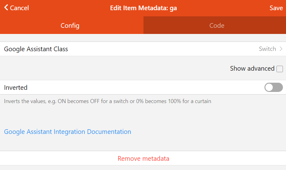

Actually, let’s try an alternative. Instead of text files, try creating an item in MainUI and add the Google Assistant metadata. If that doesn’t work, then the problem is somewhere else.
Same result
Okay, if it’s not working from MainUI then we’re barking up the wrong tree.
