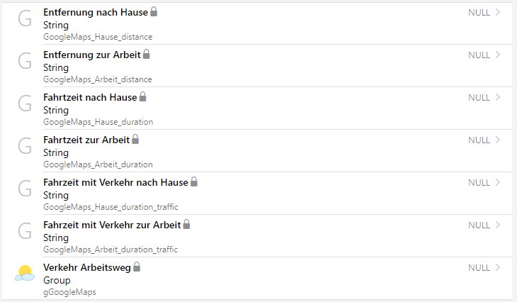

I have installed both transformation und build the items:
String	GoogleMaps_Arbeit_distance				"Entfernung zur Arbeit [%s]"				(gGoogleMaps)	{ http="<[https://maps.googleapis.com/maps/api/distancematrix/json?origins=An+der+Bringenburg+8,+49504+Lotte&destinations=Elastogranstraße+60,+49448+Lemförde&language=DE&departure_time=now&traffic_model=best_guess&mode=driving&key=MYapiKEY:300000:JSONPATH($.rows[0].elements[0].distance.text)]" }
String	GoogleMaps_Arbeit_duration				"Fahrtzeit zur Arbeit [%s]"					(gGoogleMaps)	{ http="<[https://maps.googleapis.com/maps/api/distancematrix/json?origins=An+der+Bringenburg+8,+49504+Lotte&destinations=Elastogranstraße+60,+49448+Lemförde&language=DE&departure_time=now&traffic_model=best_guess&mode=driving&key=MYapiKEY:300000:JSONPATH($.rows[0].elements[0].duration.text)]" }
String	GoogleMaps_Arbeit_duration_traffic		"Fahrzeit mit Verkehr zur Arbeit [%s]"		(gGoogleMaps)	{ http="<[https://maps.googleapis.com/maps/api/distancematrix/json?origins=An+der+Bringenburg+8,+49504+Lotte&destinations=Elastogranstraße+60,+49448+Lemförde&language=DE&departure_time=now&traffic_model=best_guess&mode=driving&key=MYapiKEY:300000:JSONPATH($.rows[0].elements[0].duration_in_traffic.text)

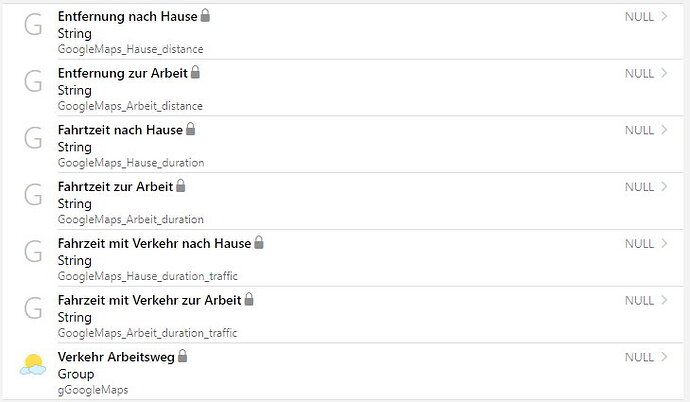

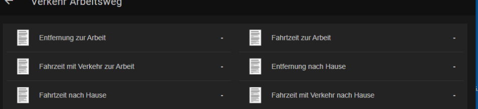

But I didn’t get any results:
OH3 shows:
At the logs I cant find that the item gut a value.
If I put it into webbrowser deritly I get a result:
It does work, but you have to use the new openhab3 http Binding. You can define the channels and items with the UI.

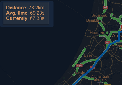

The Map is working but no label is shown like in Readme of Widget Descrpiton (see picture below):
The only thing what I see in my map is a small rectangle instead the label without any content.
Also Map is showing “For development purposes only”.
What am I doing wrong?
