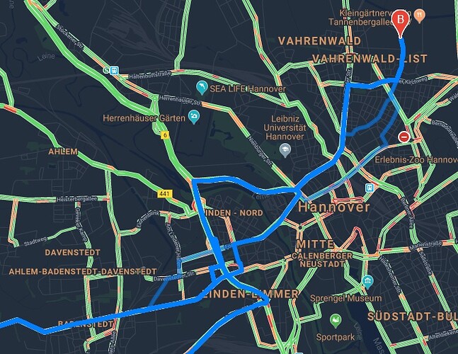

After a while there are shown multiple paths on the map, like if the old ones weren’t removed. After a manual refresh of the habpanel it shows clean results.
Has anyone encountered the same problem or has is solved?

I found the solution to my problem:
Declare
var directionsDisplay;
var directionsService;
globaly in line 77 of map.html
Replace line 176&177 with (remove local declaration)
directionsDisplay = new google.maps.DirectionsRenderer;
directionsService = new google.maps.DirectionsService;
and add after line 211 in the if-block:
directionsDisplay.set(‘directions’, null);
My best guess is that every time the directonsDisplay is replaced when updated, that the layer persists, somehow a handler is still remaining. With “directionsDisplay.set(‘directions’, null);” on a globaly declared variable the old directions-layer is removed and can be replaced by the new one.
There is then a recognizeable redrawing of the route.
Another thing that I found anoying is the “window.alert('Directions request failed due to ’ + status);” that shows a popup-message. I replaced that with a status in the panel; saying “OK” or “FAILED”
I hope that helps anyone.
