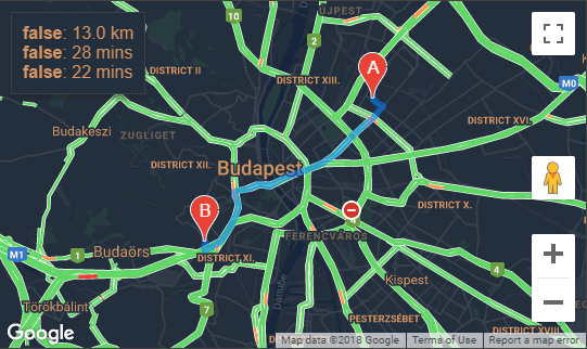

However I’m still has this ‘false’ labels on the map. Maybe it somehow connected to regional things or I don’t know, maybe someone could help me with this?
Go to google console and navigate to the libraryu and activate the Distance Matrix API, this will give permission to do distance calculations.
