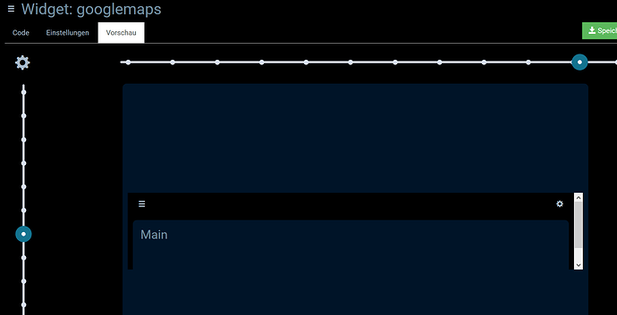

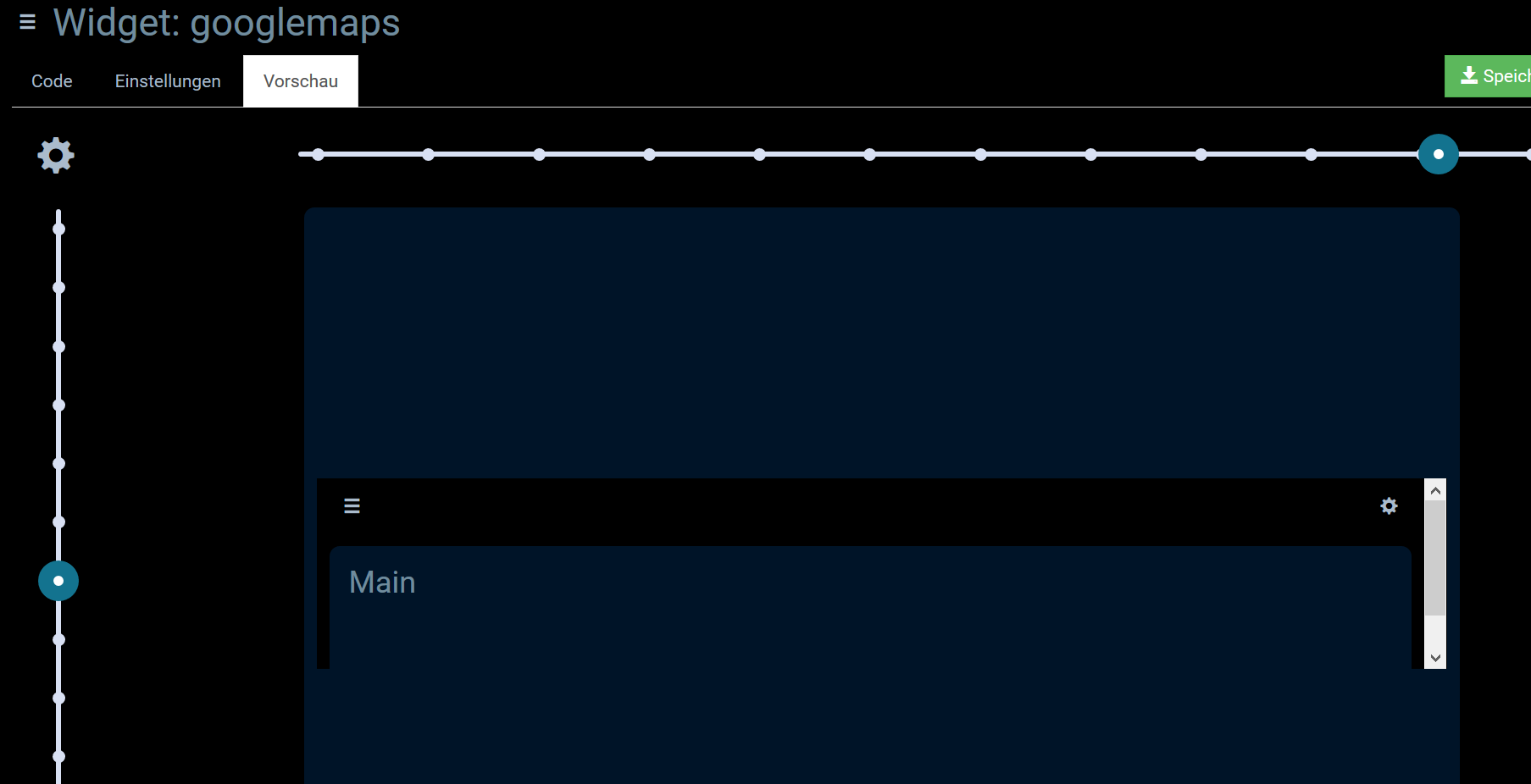

Hey guys,
I’m a little lost and hope you can help me. I really like that widget but somehow I can’t make it run. I have the same issue as sceppi and tailor. When I start that widget it just shows my dashboard
What I have done so far:
  • Install the widget according to Bastiaan’s instructions
  • Install the http-binding in the Paper-UI
  • Set parameters: (heigth = 600, serverpath: OPENHABIANPI:8080/static/google-maps/map.html, gm_zoomlevel = 12, gm_latitude = 48, gm_longitude = 10, gm_travel → toggeled off, gm_apikey = xxx)

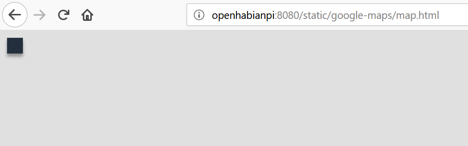

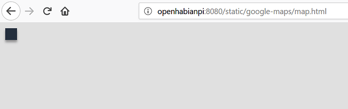

  • check if map.html is accessible using the server path shown above. When I enter the path in the browser the following is shown:
  • Additionally I changed the storage to “local” > deleted the browser cache > changed back to the server config → negative
  • Make sure that the API-key is right with another html-code > successfull, API-key works
No matter what i do - the widget won’t work. I hope you can help me with that issue. Thank you very much in advance!
Best regards
Hi
Have you changed the parameters in the widgetsettings after you added it on the dashboard?
