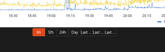

The only change I made was to add a default to the timerange widget:
    - default: from=now-6h&to=now;6h,from=now-12h&to=now;12h,from=now-1d&to=now;24h,from=now/d&to=now/d;Day,from=now-3d&to=now;Last 3 Days,from=now-7d&to=now;Last 7 Days,from=now-14d&to=now;Last 14 Days
      description: Comma-separated List of options. Example "from=now-6h&to=now;-6h,from=now-1d/d&to=now-1d/d;yesterday" for past "6h" and "yesterday". First entry is default.
      label: Time range options
      required: true
      type: TEXT
good suggestion to set some default timeranges - I used your example and updated the code in the first post.
Thank you!

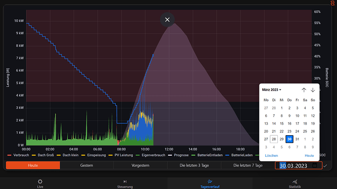

Hi, ich hab das Widget etwas modifiziert, fĂŒr eine Solaranzeige optimiert und einen Kalender hinzugefĂŒgt, noch hardcoded.

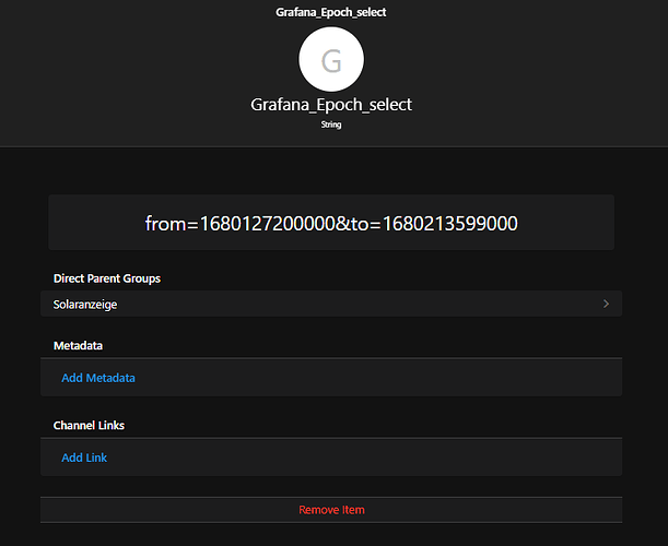

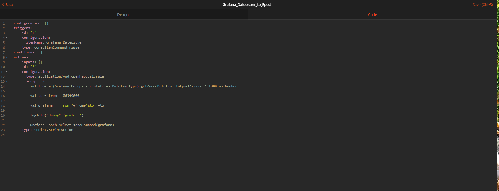

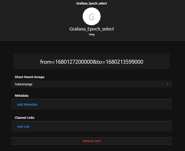

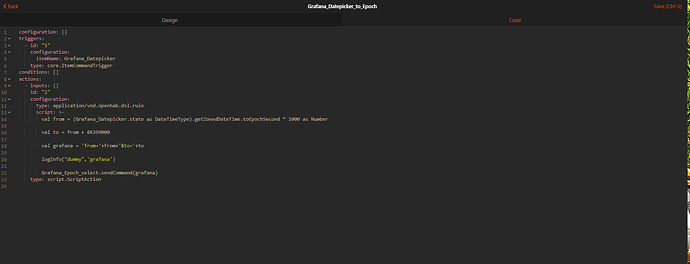

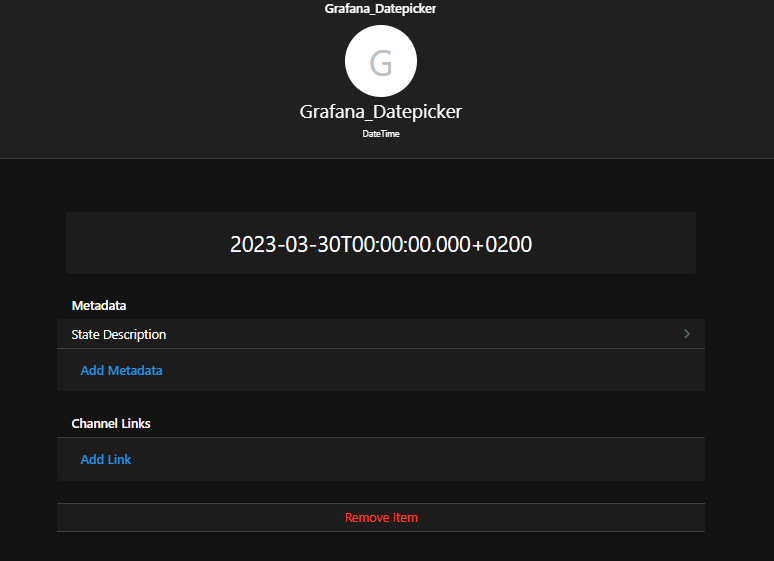

dazu musste ich 2 Items Anlegen mit einer Rule
Datepicker Item (vom Kalender)
Epoch Item (Umgerechnet nach Rule)
Und die Rule
Viel Spaß beim Nachbauen :slight_smile:

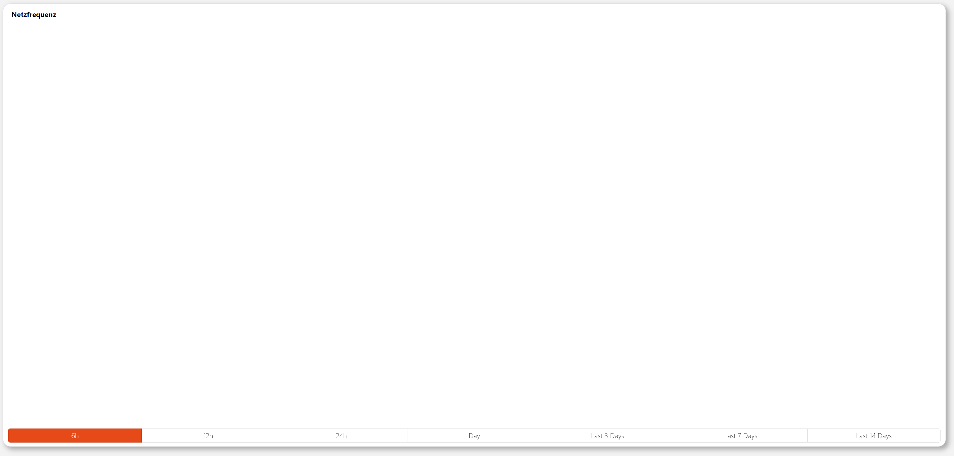

Dear community,
I use this great widget and it works fine when I access openHAB from my local PC in my local network (i.e. 192.168.86.81:8080).
When I try to access it in the Android APP or via cloud (https://home.myopenhab.org/) the widget remains empty (with a white screen). I got no error message.
My URL in the widget is:
   http://63.33.xx.xxx:3000/d/fVuLOofVz/netzfrequenz?orgId=1&{period}&viewPanel=2&orgId=1
I have to say that my InfluxDB and my Grafana are hosted at AWS.
Of course I made the necessary changes to my grafana.ini, i.w.
[security]
admin_password=jFlHxxxxxxxxxxxxxxxxx
admin_user=admin
secret_key=5690cef21b3daffd6xxxxxxxxxxxxxxxxxxxxxxxxxxxxxxxxx
 allow_embedding = true
[users]
# disable user signup / registration
 allow_sign_up = false
[auth.anonymous]
# enable anonymous access
 enabled = true
When I put in the URL above in a browser I can access this dashboard without any login.
I then tried to make a snapshot in Grafana and use this is a web frame card. This works locally as well as in the Android app as well as on a remote PC from openHAB cloud.
So I thought it could not be anything with credentials, right ?
Does iframe handle http ?
I did not manage to set up https with my AWS cloud instance so far.
Thanks a lot for your help.
Guido
Think so but
the main page is https and the embedded page / iframe content is http then http will be blocked. I would assume that you should see this being reported in the browsers console.

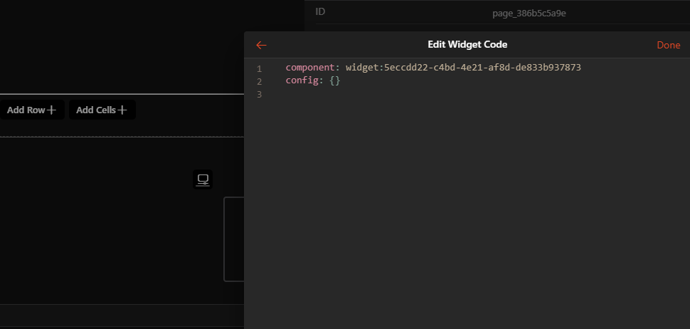

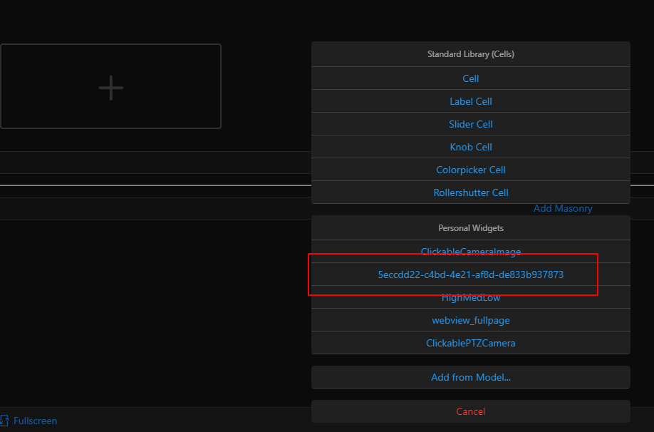

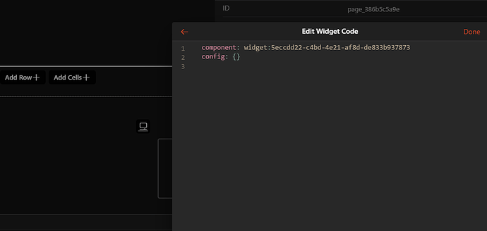

openhab newbe here.
I wanted to use this widget but when I want do add it to my Overview page (latest stable Openhab version), there is only some cryptic text (482eeeea4-d5e0-454c-9c24-528fdc523fad) I can add (which is supposed to be the grafana widget). If I do so, nothing happens on my Overview page. Is it just the wrong place I want to do that or what is missing for me?
I’ve the same problem like @krolli53.
After adding the widget to the overview page and saving the changes, the page can’t be loaded again. It only shows “Loading
The logs don’t show any abnormalities.
I’m having the same problem. Seems like this widget isn’t registering itself properly. I know this is the widget, if I remove it, this option goes away.
If I ignore that it’s not a nice name, and try to use it anyway it hangs up the page.
@maxmaximax Any ideas?
This is all that appears in the widget code:
Honestly, no idea
I’m on OH 3.4.4 with no such issues.
Which OH build are you running?
I’m on OpenHAB 3.4.3 installed on Debian 11. I just went to the market place in installed this addon from the UI page. This is how is shows up. There are others who have posted same issue here (few posts before my post).
I’ve just upgraded to OH 3.4.4-2, and this problem still occurs.
Ok so I found your widget code in that discussion you posted about (somewhere at the bottom of the conversation):
I copied and pasted that and created a widget locally, and it worked. So I believe the problem is the marketplace, or how/what is being downloaded. I don’t know if you can at least check that the widget in the marketplace is not corrupt or something?
I have installed other marketplace widgets, all successfully. So this hopefully points you in the right direction.
Thank you for troubleshooting
I will make a note in the first post suggesting this workaround until the issue with the marketplace is fixed.
