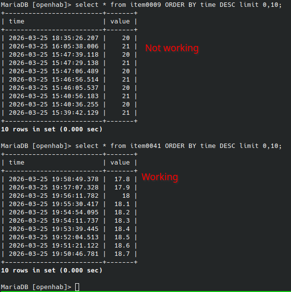

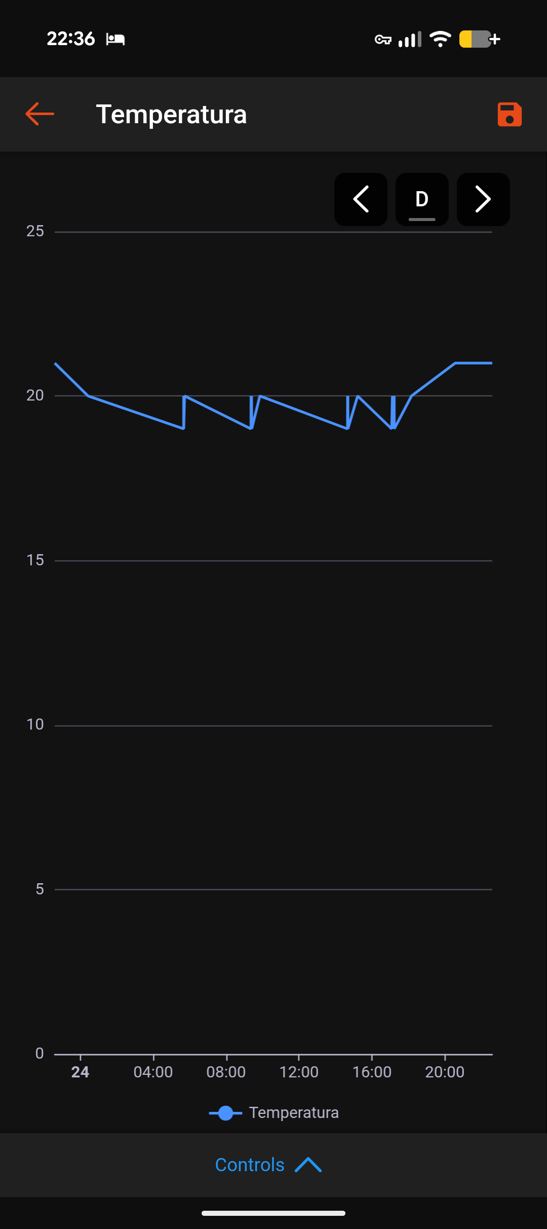

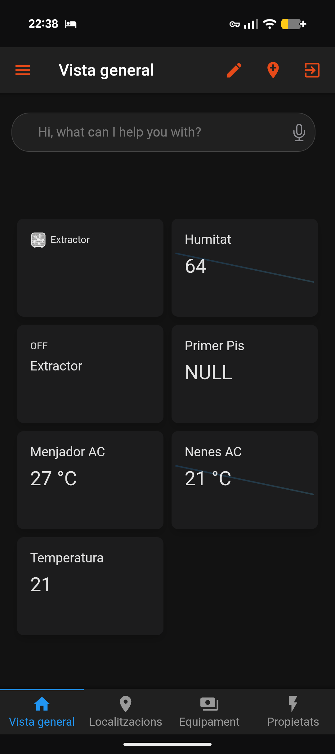

I have a temperature item, with persistence working, but trending line in cell is not working. Any idea of what am I missing? Other graphs works ok

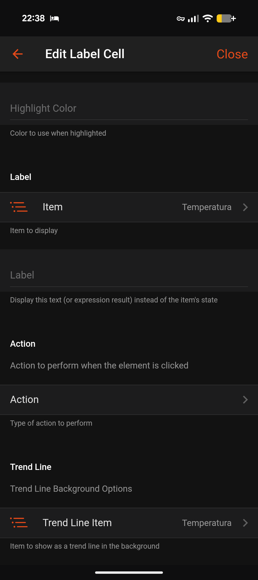

You shoud change the sampling intervall of your trendline in yaml-code. Default Intervall is the last 24 hours and every 60 minutes. If you have not enough data points, you will get a line like yours.
trendSampling: 1
Means one sample every minute.
Look here.
