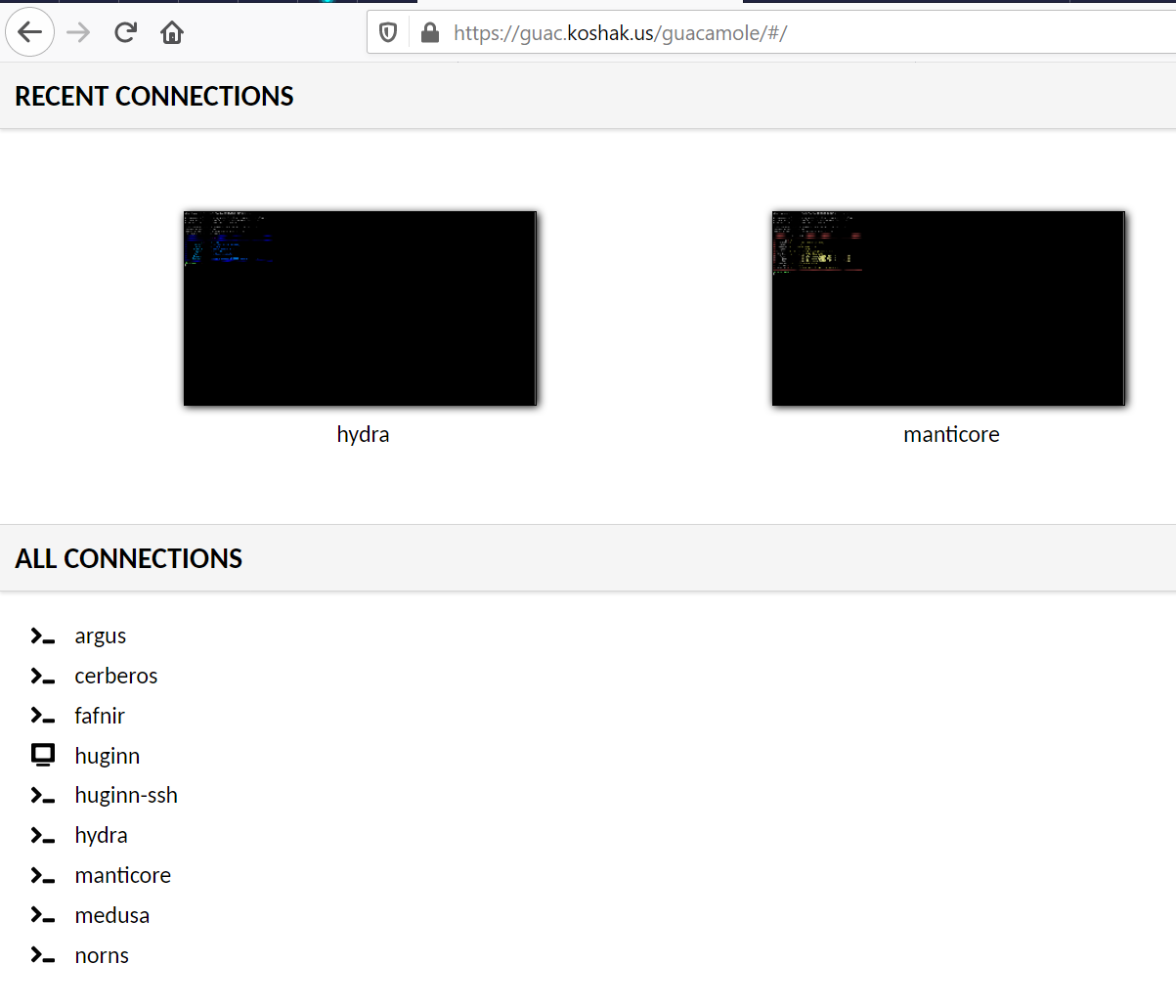

The home page:
Each entry in that list is a separate computer, with one computer supporting a VNC and an SSH connection.
