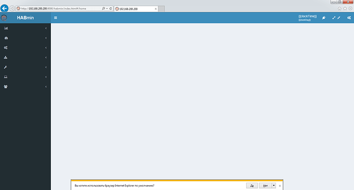

I made a fresh OH 2 with demo configuration. Add Habmin as you said and all bindings I need. But in Chrome i see only Loading… and nothing else. In IE - is on picture attached. I try 2 different computers - same thing.
I configured my zwave network in Paper UI, but in settings of multisensor 6 Save button is not active, so I cant save settings I need. (( But it is some progress.
