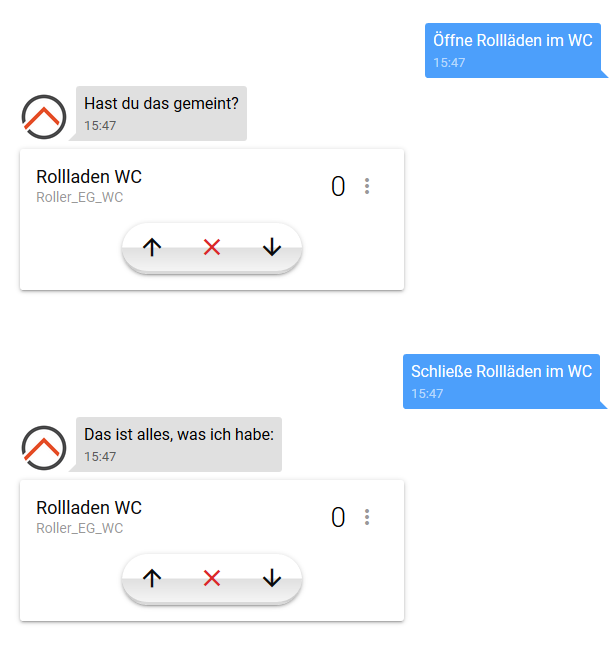

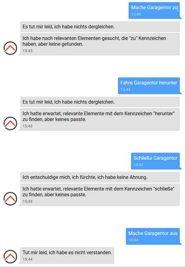

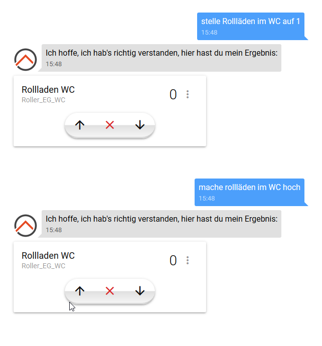

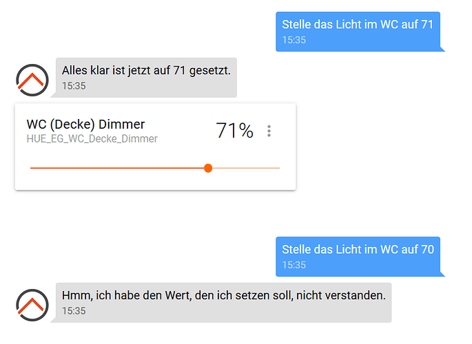

Having said this, however, I was unfortunately not able to change any state of roller shutters or garage door. And the dimmers react only to certain values.
Group 		EG_WC         		"WC"         				["Room"]
Rollershutter 	Roller_EG_WC		"Rollladen WC"			(EG_WC)		["Blinds"]			{ knx="..." }
Dimmer		HUE_EG_WC_Decke_Dimmer	"WC (Decke) Dimmer [%.0f%%]"	(EG_WC)		["Light"]			{ channel="hue:...:brightness" }
Group 		gGG 			"Garage" 					["Garage"]
Rollershutter 	Roller_Garagentor	"Garagentor"			(gGG)		["Switch"]			{ knx="...", synonyms="Garagentor" }

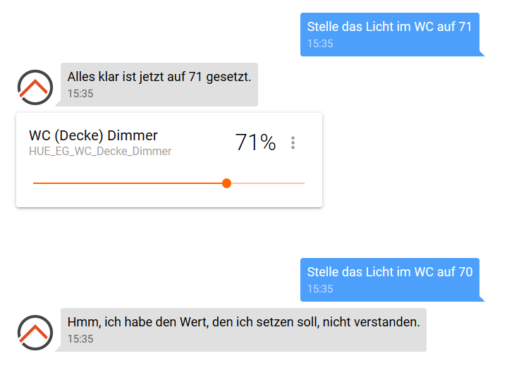

Using the above item definition, when trying to change the light to 70, I got the response that OpenHAB/HabBot did not understand the numerical value. However, when telling to change the light to 71, it works.

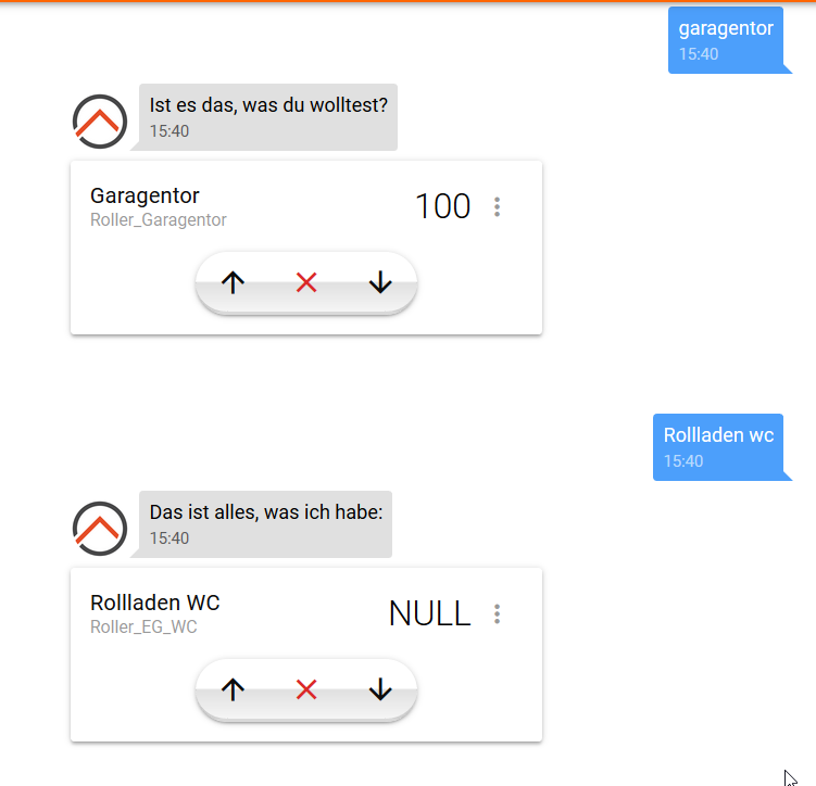

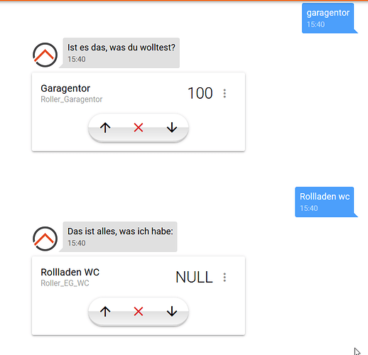

The rolllershutter in the toilett and the garage door can be found:
However, when trying to open/close them, OpenHAB/HabBot replies that it doesn’t understand my query:

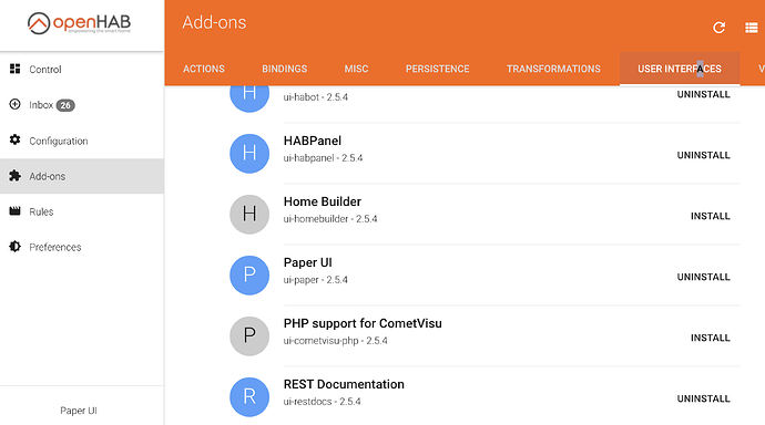

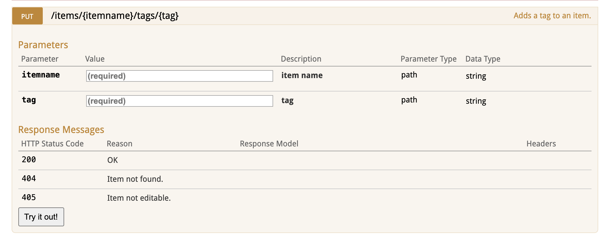

We also have an awesome swagger generated UI for accessing the API using your browser, make sure the rest docs are installed:
then go to http://your-openhab/doc/index.html and you can play with all the API’s there, specifically to add a tag, you can use this:
