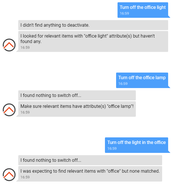

The dimmer item has an “Equipment” Tag "Lightbulb and a Property Tag “Light”. No Point Tag (does it need one?).
The item is part of the groups with the locations.
I’m still not sure what is wrong here. Can you fix it for me?
This is the item and group definition.
Group gTradfri "Tradfri" <ikeatradfri> (gAll)
Group gGroundFloor "Ground Floor" <groundfloor> (gAll) ["GroundFloor"]
Group gGF_Office "Office" <office> (gGroundFloor) ["Office"]
Dimmer TRADFRIE14Schreibtisch_Brightness "Desk Light" <desklamp> (gTradfri,gGF_Office) ["Lightbulb","Light"] {channel="tradfri:0100:gwdcefcaba8de9:65558:brightness"}
Yes. Equipment doesn’t have Properties so that “Light” tag is simply ignored. Only Points with Properties can be controlled. The Locations and Equipment tell HABot what and where but the actual control needs to be a Point/Property.
In OH 3’s MainUI it won’t even let you set a Property tag on an Equipment.
As I said, your Dimmer Item needs to be tagged with a Point tag (e.g. Switch or Control) and a Property Tag (i.e. Light). Not an Equipment Tag.
You might need to add some synonyms to the Items to help it understand what you are referring to. I bet it will work using “turn off the desk light” and possible “turn off the desk light in the office”.
